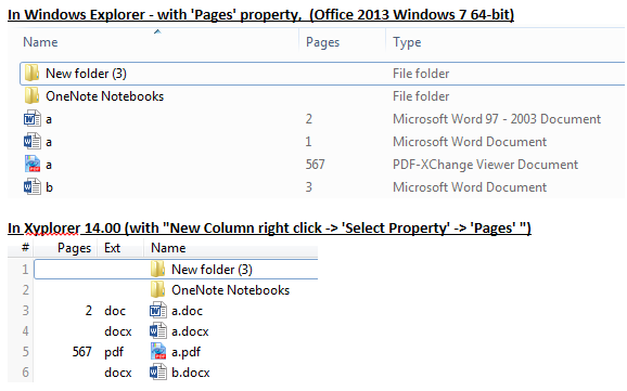

Yes, XY shows the number of pages for a .doc file and not for .docx file, But WE is showing the number of pages for both .doc and .docx (screenshot attached)

Just to add to the just-above post of mine,
In XY, the number of pages info is shown in " 'Info panel' -> 'Meta' tag " for .doc and not for .docx files
