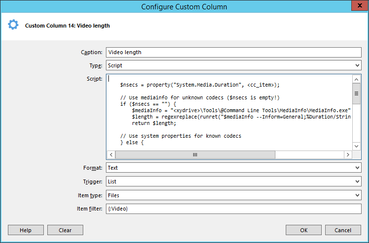

How to set up a custom column with a snippet: viewtopic.php?f=7&t=18653
This one displays the length of all video files in a folder in a custom column.

It looks like this:

This is NOT the script, this is a snippet that fills all items for that custom column definition^^
This is the script:
