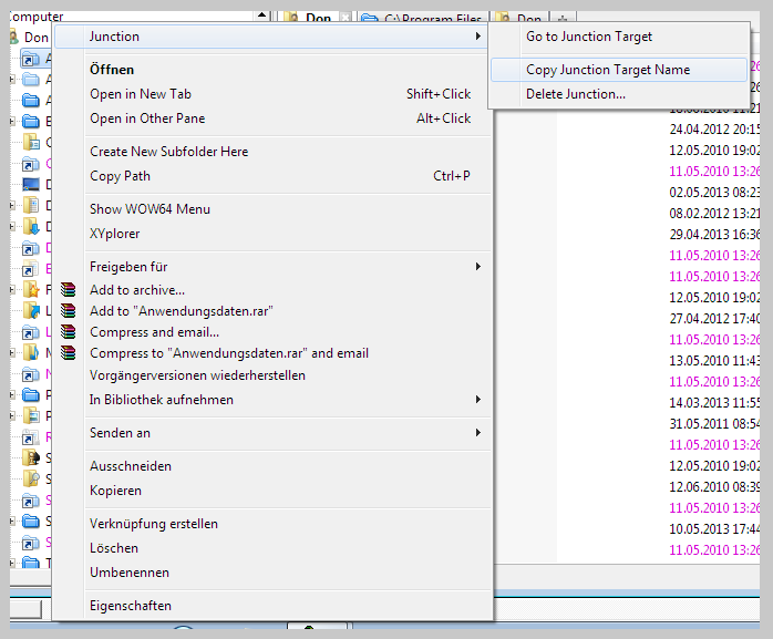

I mean this XY function in the context menu:
- JunctionTarget.png (43.7 KiB) Viewed 4027 times

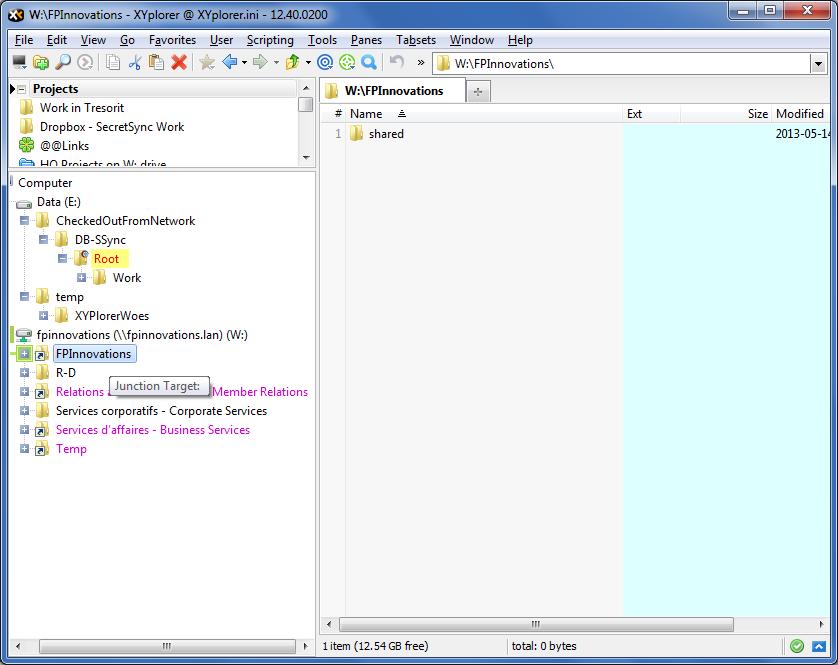

Connected to the office network, and the issue is present again - click on the Junction in the Tree, and XY returns an error that Access is Denied.
However, some "random" sequence of selecting other native folders on the drive, and then back to the junction folder makes it work properly. I haven't isolated an exact sequence that causes it to work properly. Quitting from XY and relaunching it causes the failure again, unless I repeat the action of selecting other native folders.
I do not have a "Junction" item in the right-click menu as is shown in your screenshot.
Went into Configuration, in the Shell Integration section. Noticed that "XYplorer in shell context" was unchecked
Closed XY and re-launched, using Run As Administrator. Opened the Configuration, and checked the XYplorer in shell context. Closed the Configuration. Still no "Junction" item in the right-click context menu. I must be missing something in the Configuration.
When hovering over the folder in the Tree, a popup appears with "Junction: " (however, no path is shown for the junction. There is just the caption title)

To see Junction in the menu ensure that this is ticked:
Configuration | Menus, Mouse, Safety | Context Menus | Custom items in shell context menu

Note that the Junction item is only present when you right-click a junction. Still not?

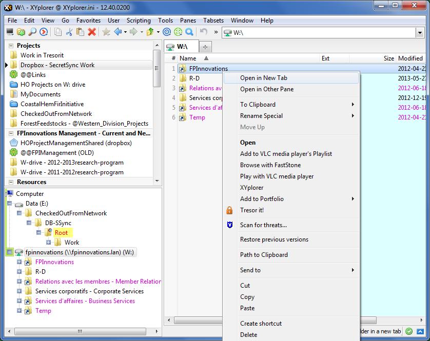

I went to a folder on the local hard drive and created two new items: a Junction to another folder, and a Symbolic link to another folder. Tried the right-click on both of them, and it worked successfully -- the Junction item was displayed on the menu.
Returned to the network share where the folder exists that is causing me the problem. Right-click does not display the Junction item. There is a definite difference between the local drive and the network drive behaviour.
I am *assuming* it is a Junction -- I did not create it myself. It is coloured Magenta, which is defined in my color filters as "attr:junction". When I hover the mouse over the item in the Tree, XY pops up a textbox that *says* it is a junction, but does not provide any additional info (hovermouse.jpg).
- right-click-menu.jpg (99.53 KiB) Viewed 3947 times
- HoverMouse.jpg (64.85 KiB) Viewed 3947 times
