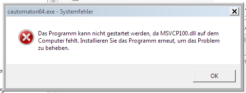

But...
... I tried it in my VirtualBox Win7/64 and I got an error message:
But...
- 2013-03-13_203251.png (7.29 KiB) Viewed 8936 times

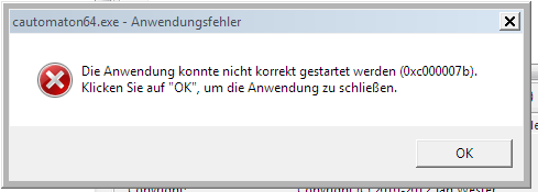

In the meantime I downloaded the missing file from http://de.dll-files.com/msvcp100.dll.html, and placed it in the folder of C:\Program Files\Cautomaton\cautomaton64.exe.
But now I get another error:
- 2013-03-13_210338.png (7.2 KiB) Viewed 8929 times

Ah ... I didn't attempt to read the German in your message box. But "MSVCP100.dll" caught my eye.
Dependencies: you maybe need the Visual C++ runtimes on your system. From the author's page.
http://whitehat.dcmembers.com/pages/sof ... omaton.php
Requirements
Windows XP or newer. Both 32-bit and 64-bit varieties are supported.
Microsoft Visual C++ 2010 Redistributable Package (x86)
Necessary for Cautomaton32.exe to work.
64-bit: Microsoft Visual C++ 2010 Redistributable Package (x64)
Necessary for Cautomaton64.exe to work.
