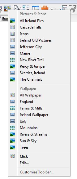

Re: Detect left vs right click on a CTB
Hi Stefan,
I used your suggestion of "load self(file)" in lieu of using "sub" and the results were great with one exception. For the "right" click, I receive the following screen and have to click on the "_rightclicked" menu item to get the actual "right click" menu I want to see. Edit: I meant to say also, when stepping through the script, this menu comes up in the very first step after right clicking. Obviously, the right click menu would display properly when using 2 separate scripts - one for left, one for right click. The normal or left click menu displays immediately when I left click as it should. Do you have any idea what I might be able to do to bypass that intermediate menu (the one shown above) and have the script immediately display the right click menu or should I say the right click menu I want to display. If we can't get around this issue, I'm afraid I'd might as well go back to 2 separate scripts unfortunately. By the way, this is what I would want to see if I right clicked - results using 2 separate scripts. It's a nice technique though and one that I'd use in other ways if we can get beyond this issue. The options based on the "$click" variable worked great.
Thanks so much,
Ken
Thanks so much,
Ken
Hey again Stefan,
I think I found an answer to my previous post. The script now does what I need it to do (i.e., uses only one script and does something different using left click vs a right click). It's certainly not a complete fix nor is it what I was initially hoping to do.
As I stated above, it was only the "right click" option that led to a the intermediate menu that I showed above. No matter what I tried, I couldn't get the right click menu do come up directly.
So in the CTB I used the following:
On click: load "D:\Tools\Xyplorer\Scripts\ThumbnailViewer_exec.xys", "_leftclicked";
On right-click: load "D:\Tools\Xyplorer\Scripts\ThumbnailViewer_exec.xys";
In the first part of the script I did the following:The "right click" simply executes the script ignoring the hidden label, and the "left click" executes the hidden label, sets the variable to "L", and loads the script. Both options result in the identical menu displaying but result in different actions due to the variable.
Variable $click "L" is used to determine the action path taken. The way I figure it, you only have 2 choices, "Left click" or "Right click". So if it's not a left click, it has to be a right click. So further in the script:If you figure out a better or smarter way please let me know. Thanks for all your help Stefan,
Ken
Hey Stefan, I agree totally. It would be nice to have a built-in way in scripting to determine if you Left clicked or Right clicked a CTB. It's funny you asked what you did, because in this post http://www.xyplorer.com/xyfc/viewtopic.php?f=5&t=8231 awhile back I asked Don if it would be possible to not have the Click, Edit..., and Customize toolbar... menu items display when you "right clicked". In other words, have a tweak or code change to disable seeing those items when you "right clicked". You can easily assess those menu items by holding down the control key with a right click anyway. Yes, it's just aesthetics but why not.
So what we are asking (i.e., to have the right click immediately open a menu when loaded via a script label and somehow recognizing when a right click is used vs a left click) actually goes hand in hand with what I asked above. Unlike you, I'm far from being an expert at scripting, is that essentially what we would like?
Thanks again,
Ken
Thanks again,
