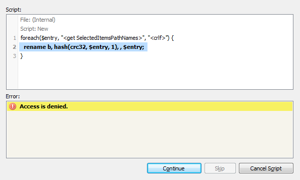

I got an access denied error. Attached is the error snapshot.
Posts: 15016
Re: CRC32 String as File's Name?
On a specific file? Permissions?
