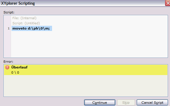

a simple address line command
::moveto D:\Ph\0\M
(this folder is existant, an item is selected)
brings a message:
XYplorer Scripting
Script:
File: (Internal)
Script: (Untitled)
1moveto D:\Ph\0\M;
Error:
!Überlauf
0\0
Continue
Cancel Script
"Continue" brings the same error message again.
The same with other such commands, items or folders. Where could lie the problem?
So this command did function 2 or 3 times, then never again.
::moveto D:\Ph\0\M
brings a message:
XYplorer Scripting
Script:
File: (Internal)
Script: (Untitled)
1moveto D:\Ph\0\M;
Error:
!Überlauf
0\0
Continue
Cancel Script
PeterB
- Posts: 19
- Joined: 09 Oct 2012 19:04
Re: Is there a command line?
Here is one of many identical screenshots, with 1 or several items (here it was 2 items), with many different folders...
I closed down XYplorer, and reopened it, this screenshot is from the reopened XYplorer (10.80).
You have to put quotes " to avoid errors.
::moveto "D:\Ph\0\M";
