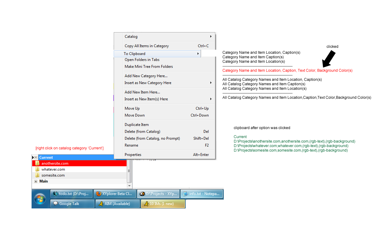

Currently, when right-clicking on a catalog category, it brings up a menu where the "Copy all items in category" option (and other options) exists. There should be "To Clipboard" option menu with sub-options in this area, similar to file lists. Not just the ability to copy the paths of the selected category's items, but the items in ALL categories of the current catalog as well.
I believe the rationale behind the catalog, according to XYplorer's developers, is a user defined, 2-level tree (the category behind the parent / 1st level, and the items [files and folders] underneath each category behind the children / 2nd level) of commonly accessed files and folders. It's really a custom file/folder shortcut list. And just like normal file lists, the option to copy the items to the clipboard exists. So why not extend clipboard options to the catalog?
Also, it would be nice if one of the options under "To Clipboard", if this feature were to be made, should include the ability to copy not just the Item Caption and Item Location, but also the Text and Background colors. This is kind of similar to the "To Clipboard > Select List Row(s)", but since catalogs don't have columns, this data would be nice to have in its place.

Post by jlahijani »
jlahijani wrote:Thoughts?
Please give an example of a bunch of data how you would like to have them exported.
This screenshot demonstrates a potential "To Clipboard" menu when right-clicking on a catalog category, which I came up with based off of the current "To Clipboard" menu when right-clicking on one or more files.
The resulting data that is copied to the clipboard is shown in green. Self-explanatory as to what the data will look for the other options.
Posts: 67270
Re: exporting catalog categories + category items (with color)
Thank you, very clear.
However, I think this would be an overkill for 99,9% of all users. I will think about a scirpting solution...
