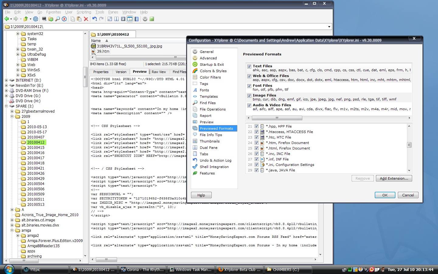

I dont know why, but i'm not able to see html pages as webpages, and i use to in PREVIEW. I have IE6 install, thought it may be a problem with IE8 so i uninstalled that. But that didnt fix it, i removed my .ini file and other files in xyplorer folder to see if it would fix it, but nope, it has to be some stupid, I'm using xyplorer 9.30 and its been like it since 9.10.

Mind the settings:

Re: not able to see HTML as HTML
Yes those are ticked, always have been, i didnt make any changes to that.
As you can see by the screenshot, html is showing as though its in Raw view.
the file is a htm file, 39.htm as an example, but it does it on ALL html, htm files.
I've uninstalled completely, reinstalled, deleted the xyplorer.ini file, and redone all my settings.

- picture showing what i meant

I forgot: you have to untick it under Text Files!
Doh!! I feel like such a fool, its working. Thank you, thank you, a thousand times thank you.
