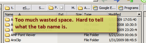

May I suggest to make better use of the space available in the tab titles in the titlebar? When you have a lot of tabs, there's so little space for words, so the real estate is very valuable, in a sense. I would like to add an option to delete the use of ellipsis (the "...") when a word doesn't fit in the tab. The ellipsis takes up way too much space; I'd rather show as much of the word as possible and cut the rest off.

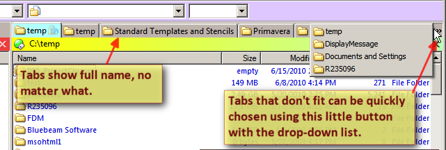

Now, I feel Directory Opus does a good job in this area. let me describe how it handles this. First, the entire directory name is shown in the tab. if the tab has to be long, then it will be as long as it has to be to fit the entire name. Even though XY has the maximum tab width option, it doesn't really help when you have a lot of tabs, because it tries to fit them all on the titlebar. in Directory Opus, if the tabs don't fit (to show the whole name), there's a little button that appears on the side. When you click on the button, you will see a drop-down list that shows the names of the tabs that are could not fit in the bar. I feel this is a very good solution to the problem (it was my suggestion, in fact). So I suggest something similar to XY. The way it is right now, I have a bunch of tabs with one letter shown and ellipsis...that's not very good.
I've attached a screenshot of XY and also of Dopus, to show what I'm talking about. I hope it helps.
Here is how XYPlorer does it: here is how DOpus does it:

The drop-down list shows all non visible tabs - those above the divider are to the left of the visible tabs, those below the divider are to the right. No problem seeing the names of all the tabs.

That is rather clever.Forty-Two wrote:The drop-down list shows all non visible tabs - those above the divider are to the left of the visible tabs, those below the divider are to the right.

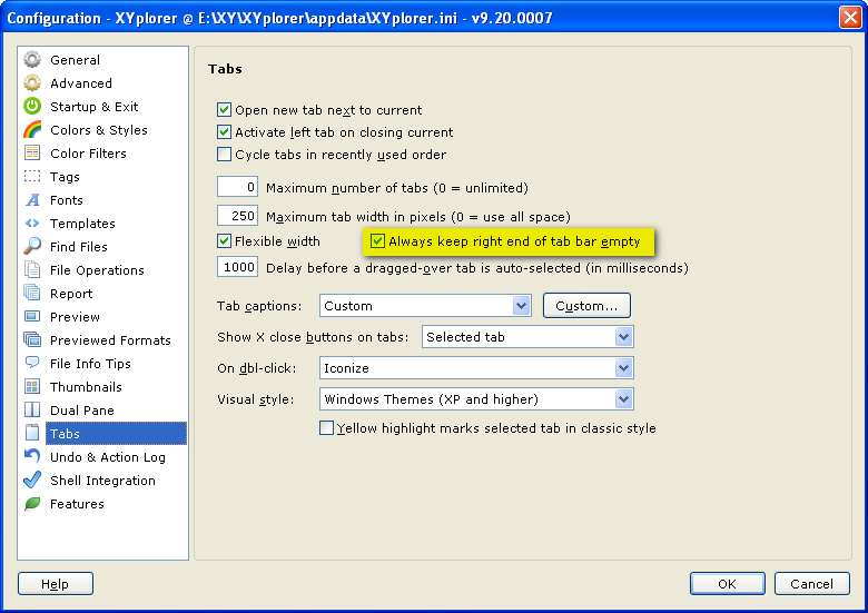

Best used with "Tools > Configuration > Tabs > [X] Always keep right end of tab bar empty"Forty-Two wrote:The drop-down list shows all non visible tabs - ...

Maybe not everybody knows that you can right-click the empty space on the tab bar's right end to get a popup with all tabs names in full from where you can select a tab.
To keep the right end always empty use the setting shown in the screen shot:

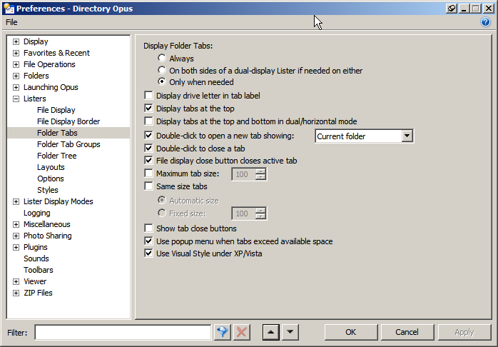

i didn't know about the right-click thing, that is really nice! I guess it's not that big a deal to add buttons or not. The other thing to consider is do you want all the tabs to show up in the right click menu, or just the tabs that don't fit? There should at least be an indicator that tells you which tabs are visible or not.
But the first issue still remains: the efficient use of space within the tabs. Can we have an option to show the entire tab name without ellipsis, no large blank spaces, etc.?

But with XY, my biggest issue is that currently the space on the tabs is not used as efficiently as can be. you have the left side reserved for the icon, then 99% of the time, the entire word doesn't fit, so when it doesn't fit, the ellipses is used which takes up over half the space. So you are left with "P..." for a folder that is named "PROGRAMS".

I don't want to turn this into a competition, but I feel it's constructive. The image below shows the amount of options available for tabs in DOpus. it would be great to get some of these in XY. I mean, DOpus is known for having loads of options. But XY does a lot of things better than DOpus, too. So, I guess I'm trying to say I'm a fan of both. I definitely like XY's author a lot more
