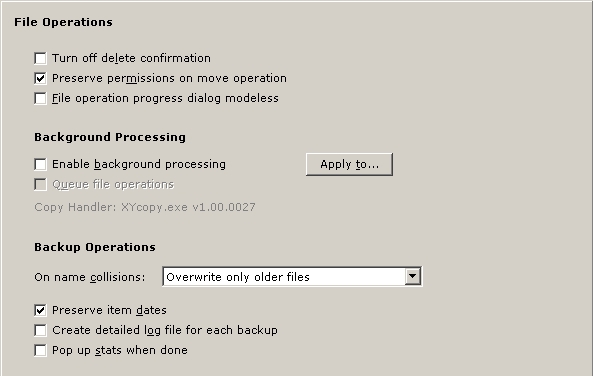

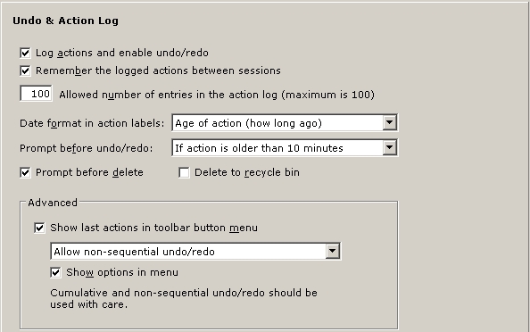

At the off-chance that it's a setting, could you post a screenshot of both:SkyFrontier wrote:...tell that my machines...admin wrote:Sorry, but that's nonsense. All such file operations are logged, no matter from where to where.SkyFrontier wrote:-XY does NOT logs for undo: dragging from pane to pane; dragging from tree to pane; dragging from pane to tree; dragging inside the tree.
- Configuration > Undo & Action Log;
- Configuration > File Operations?
(I appreciate that you've probably checked and re-checked those settings, but sometimes it helps for others to look afresh.)
SkyFrontier
- Posts: 2341
- Joined: 04 Jan 2010 14:27
Re: Actions Not Being Logged for Undo - part 2
...there they go...
Thanks for trying, nas8e9.
nas8e9
- Posts: 2232
- Joined: 21 Jun 2008 14:50
The obvious settings are there, of course. I'd personally enable background processing and operations queueing, but that has nothing to do with the problem you're reporting.SkyFrontier wrote:...there they go...
To eliminate the small possibility that some *combination* of settings causes your problem, could you try it with a default configuration? (The easiest way is to copy XYplorer.exe to an empty folder and run it from there.)
