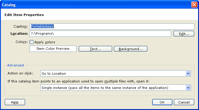

<xypath>sorry but at the moment none of those indirect helper variables work. Maybe i do it wrong, so i added an screenshot for "?:\" Solution. If you browsing currently drive C it replace ?:\ with C:\ on drive D with D:\ and so on
- SettingsForShortcut.png (14.58 KiB) Viewed 3721 times

Indeedsweety wrote:doesn't work it chose the drive which you are currently browsingCode: Select all
?:\Dokumente
