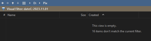

1) The example formats in the help documentation is not working, such as dateC: 2023.11.01.

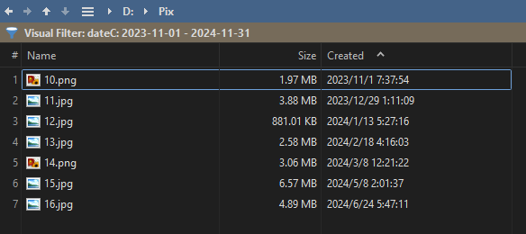

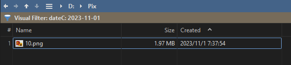

2) Changed to dateC: 2023-11-01 or dateC: 2023-11-01 - 2024-11-31 works, but dateC: 2023-11-01 - does not.

But dateC: > 2023-11-01 works, fix or remove the example in the help documentation. . .
XYplorer 32-bit and 64-bit.
Posts: 67063
Re: Filter by date range
All confirmed. Fix comes (32/64). :tup:
