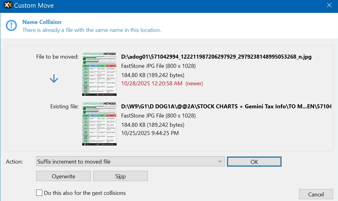

When using Custom Move on say a selection of 50 files there may be 10 files that I skip. I need the selection with a checkmark in the small box to remain.
At best this is inconsistent. Is there a setting that I am missing for this?

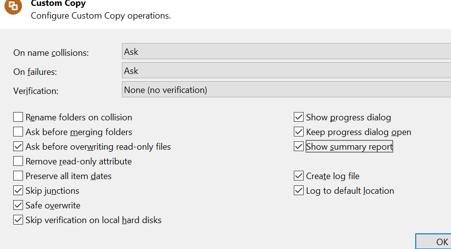

In Custom Copy Configuration, enable "Keep progress dialog open" and "Show summary report", OR only the later one = then you'll have dialog auto-closing but remaining for few seconds if you decide to open Report.
For pity there is no option to configure like "Auto-open Report Only when there are Skips" or "..when there are Failed", though i would like to see that too.

I entered the items you mentioned - I now have the attached settings.
I tested with Overwrite, Increment, and Skip. A couple of times I got the Skip only - as we want it. I'm short on time, but conclude that something random is going on.
Any of the jpg files that I "skip" will need further work. This could be a deletion, a rename, or simply ignore.
It would be most helpful if these 'skip' files have the selection check mark.
Memory is generally not enough.. Writing down the file names is super boring.
I think you would want to assist with this in order to maintain the high standing of XY.
When I say latest version, this means 'the official version' which has been 32 bit so far.
Posts: 67248
Re: How to save the selection of all "Skip" files?
That's not possible. The skipped files could be spread over multiple directories. There is no way to save such a selection pattern.
What you still could do:
- show the report for skipped files
- copy the list to some editor
- cut the "Skip " prefix from each line
- use that list Edit | Select | Select Items...
