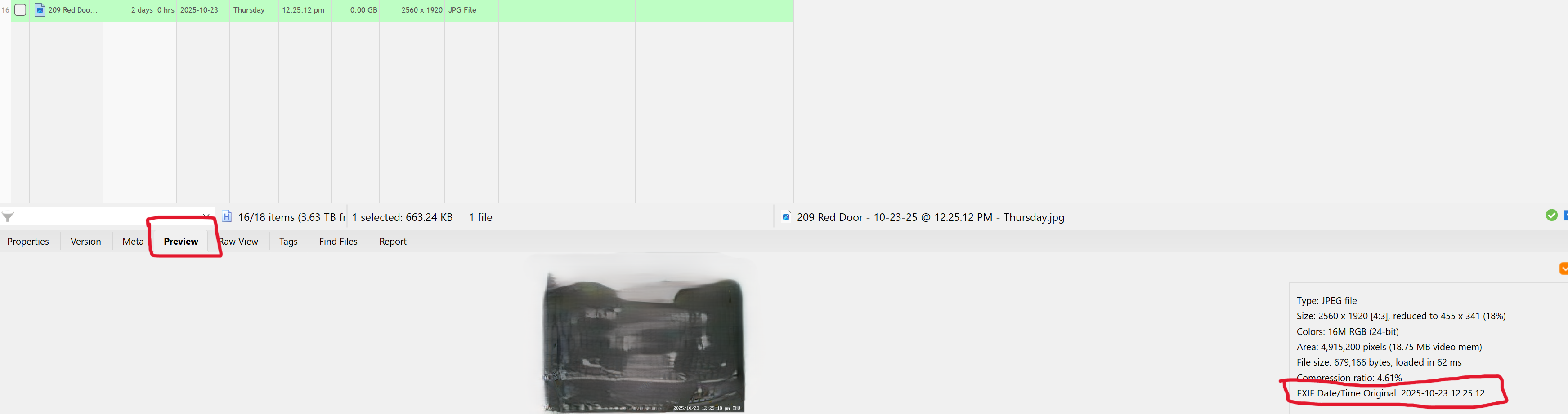

I ran the script and it appears to have set the EXIF Date/Time Original to the created date of the file where that had not existed before. I see that when I select an updated file & click on preview in the info panel. I don't see the date taken though when clicking on Meta tab on the info panel as I can see the date taken with my phones camera when I click on the Meta tab. It looks like there are two types of "Date taken", one in shell properties and one in special properties. I can see date taken of these updated files under special properties & not shell properties. Is that how its suppose to work?

This is a file where the EXIF Date/Time Original was set to match the created date after running the script as you can see it is indicated near the bottom right of the screenshot. It had no EXIF date before running the script.

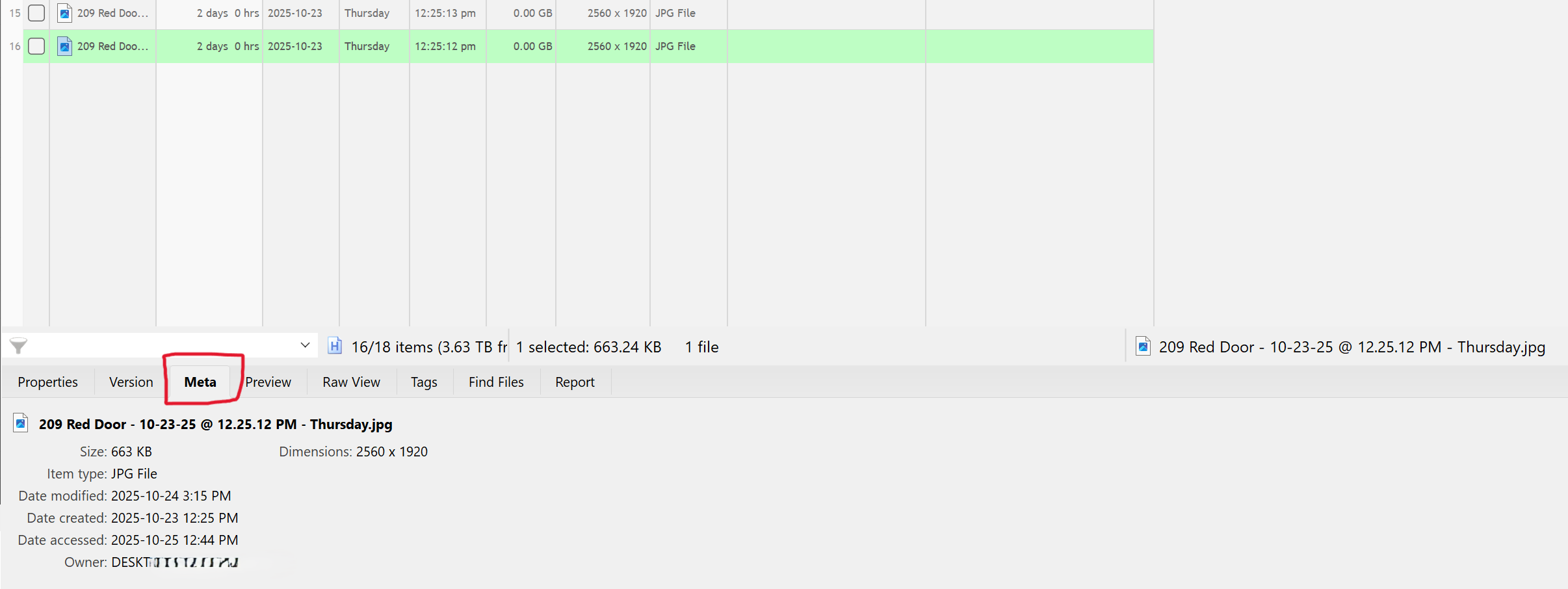

This is the exact same same file, also after running the script but with the Meta tab selected and you see it shows no Date taken.

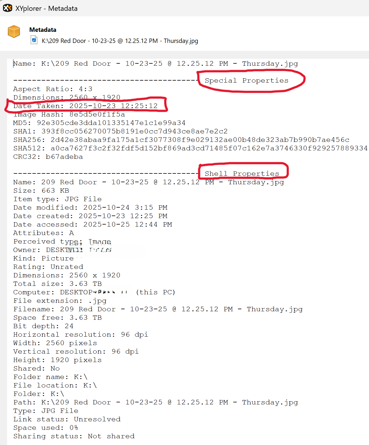

And again, this is the exact same file, also updated/date set after running the script, but I right clicked on this one and selected Metadata and you will see the Date Taken is under Special Properties and is not shown under Shell Properties.
It seems everything is okay.
