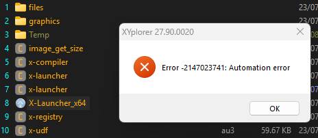

I changed that settings to Hide Shell Extensions. Was working until now.
I've selected a bunch of AU3 source files, and two folders containing some files.
Right clicked and got an error. I can only click ok to close the window.
I can carry on with other things, but I want to copy those files to the right hand pane, but everytime I right click on them, I get that erro window keep popping up.
Does that help?
Here's a screenshot:
Does that help?
sl23
- Posts: 280
- Joined: 03 Feb 2015 23:34
- Location: XYplorer 64 Latest beta, Win11x64 25H2, 1920x1080 @100%
Re: XYplorer64 TB v29.90.0020 - Right click causes constant crashes.
The error in this case seems to be linked to that ISN file: X-Launcher_x64.isn
If I select that file alone, I can right click it. But if I select even one other file with that one, it gives the error.
I've selected any two files in that folder and it only gives an error when I include that file as one of them.
Weird as that file is just a simple plain text file.
EDIT: I tried restarting Windows Explorer and XYplorer64, then tried selecting all files, except the ISN file, still get the error. Seems that folders or the contents of them is having an effect. If I select one folder and one file, I get the error. But I can right click any single folder or any single file without issue. CTRL+C and CTRL+V works fine.

sl23
- Posts: 280
Well, I did, but I can't tell as I don't know if the error was in place of the crash or something else entirely? I just supplied the info I had:
But if there's anything else you think I could try to debug, then please let me know.sl23 wrote: ↑06 Aug 2025 16:31 I changed that settings to Hide Shell Extensions. Was working until now.
Does that help?

sl23
- Posts: 280
Apologies for the confusion, I thought I made it clear but I see it isn't!
Ok, so changing the setting stopped the crash and I instead got the error message posted above.
Since then, I reverted the setting as I needed those context menu items to be shown, but have had no more crashes or error messages.
Not much help, I know, I''ll repost here if I can provide any further help on this.
