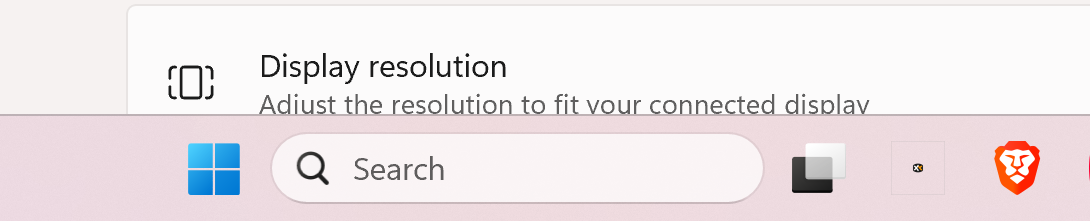

For clarity, this issue is exclusive to the xyplorer icon and I dont have this issue with other pinned apps.
I run Windows 11 on a 4k monitor and have scaling at 250%, This forces the pinned taskbar icon to be tiny even though the notification icon and start menu icon are fine.
If i reduce the scaling to 200% then it looks fine. If i try 225% then the icon is small again.
The reason I have the scaling so high is because I am using the computer on a TV and sitting a few meters away from the screen, so reducing the scaling to accomodate the icon isn't really an option.

Just fyi, here is the fault duplicated on a fresh install of W11. 225% scaling at 4k resolution. Different pc and monitor.
I have tested another 32bit application and its icon is also small...so hopefully this is just an issue that will disappear like you said.

Re: Windows 11 pinned taskbar icon is tiny
I think 225% scaling is quite extreme and not normal for desktop use.
I use a small mini pc on my 65" TV and sit several meters back so I tend to set the scaling to over 200%. However, for the moment i have reduced to 200% and just zoomed in with the mouse wheel for the browser and other apps that support zoom.
