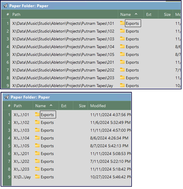

This started out as a thread with a problem i thought was specific to Paper Folders.
All the target folders have the same name so they can be distinguished by only using the immediate parent folder as shown below.
Paper Folders.png (64.3 KiB) Viewed 1163 times
After shortening the Path and saving a Folder View I thought it would allow me to do this but no luck as it always reverts to the full path.
I tried this with normal folders and have the same problem, resizing the columns always revert back to the default size.

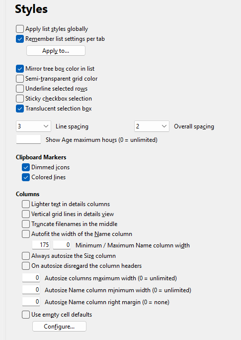

ScreenHunter 383 (01).png (19.21 KiB) Viewed 1130 times
ScreenHunter 384.png (24.73 KiB) Viewed 1128 times
Are there other settings causing this?

These were the settings in place
ScreenHunter 386.png (16.66 KiB) Viewed 1125 times
I repeated the sequence you listed and saved Xy settings but the column width still reverts after toggling to a different tab.

Given this setting and the column settings in Configuration\Styles, what takes precedent?
Posts: 3292
Re: Unable to Save Resized Columns
Autosize has priority.
