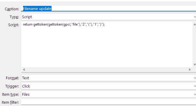

If my file name is this:
2024-09-19(209CT-209Hydro&Water) $842.28
What exactly do I write in the script area of the custom column configuration to return exactly this into a custom column:

Posts: 4459
Location: Windows 11, 25H2 Build 26200.8037 at 100% 2560x1440
Re: How to return all characters after ( and before ) in a file name
Just what highend stated (gettoken *2) so any donations should go to him.
return gettoken(gettoken(gpc(,"file"),"2","("),"1",")");
Schuller
Posts: 195
Joined: 02 May 2023 21:08
Post by Schuller »
I put exactly:
and it returns nothing
Posts: 14946
return gettoken(gettoken(<cc_base>, 2, "("), 1, ")");

Posts: 4459
Yeah, it worked for me, but I should have used <cc_base> for use in a custom column>. :whistle:
