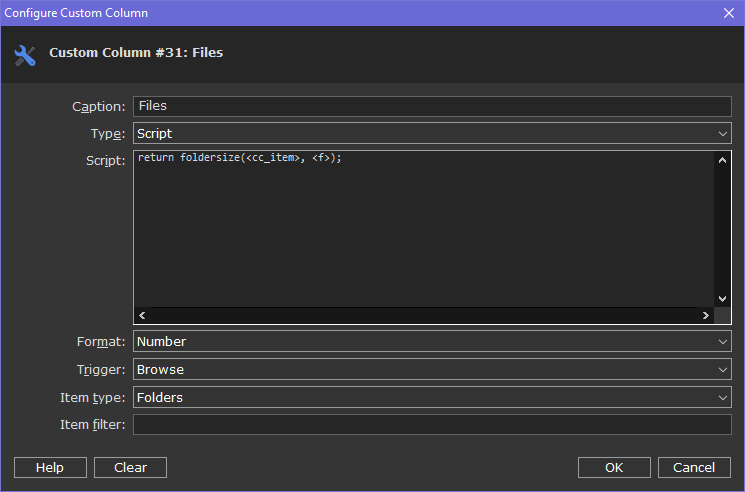

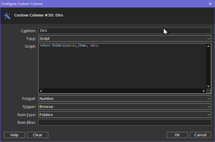

Maybe it has to do with these two custom columns I always use:
Dirs column.png (8.49 KiB) Viewed 1387 times
Files column.png (8.3 KiB) Viewed 1387 times

Ah, that's what I thought. Relevant things are happening in the background. You use scripted columns that run a deep process for each listed folder. You also use background copy threads.
A first question would be: Why are you scripting folder sizes when you could just turn them on from the GUI?

Because the default one doesn't work (at least, they didn't used to when I looked at it years ago).
Are you saying I can get the split columns by other means?
I want to keep the file and directory count separate because I want to be able to sort on them.
Please tell me how I can set it up 'natively'. Currently, the calculations are quite slow. So, if a 'native' way is faster with the same result, that would be great!
Also, the calculations of the scripts are not done in the background, so I always have to wait for them. If they couldn't run in the background and just show me the result when ready, it would be MUCH faster.

1) What kind of sorting are you looking for that cannot be achieved with a single Size column?
2) With the Size column you can use folder size caching.

Which column do I need to use to count the amount of directories and files in a directory?
I tried the 'File count' column, but it doesn't do anything:
XYPlorer Column Doesn't Work.png (75.43 KiB) Viewed 1319 times
(\__/)
(='.'=) This is Bunny. Copy and paste bunny into
(")_(") your signature to help him gain world domination.
Posts: 65009
Re: Incorrect display after moving a file from split
File count is some shell property, I would have to google it to find out what it's supposed to do.
So you're after the file count. Okay, in that case you have to use Custom Columns indeed.
