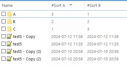

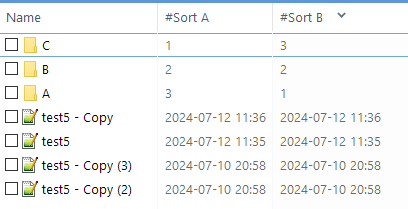

I'd like to implement special sorting:
Always sort files descending by date modified AND Be able to swap sorting of folders alphabetically either descending or ascending.
Image Image
So I am using two custom columns #SortA and #SortB, mixed type, format date (and date columns are globally set to be descending by default). Taking the date for files and taking a scriped column for folders.
There are two hidden scripted columns, for each sort one. And one scriped colums assigns numbers to the folders ascending and the other one descending.
So I just switch between #SortA and #SortB. The files stay and the folders are switched.

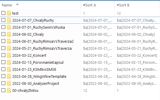

The problem comes when there are numbers around dashes in the folder name:
I come from Lua and its tables, this would be basically done the same way in Lua, with associative array/table. I guess it could be done another way but this seems to me the fastest to code. Associative array is a nice thing but at the moment we are not able to use filenames as keys and considering this is a file manager it is not nice. Could it be fixed somehow...?
Or could you suggest another way how to make this done? I am new to xyplorer.
Posts: 66351
Re: Associative array call with a math expression inside doublequotes vs singlequotes
Okay. A lot of work.
Change the last line of your script to this and the problem goes away:
return $a[quote(<cc_name>)];

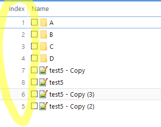

And a question - is there a way to obtain the "Index" column property in a scripted column script? In my script I could just take this and subtract it from the subfolder count and would not have to loop through alll the subfolders.
Posts: 66351
Folder and files can mix if you sort by Index. But I think it does not matter for your algo. And is it really necessary to subtract the count? Why not just sort by Index?
But how to retrieve the Index? Hmmm ... highend?
