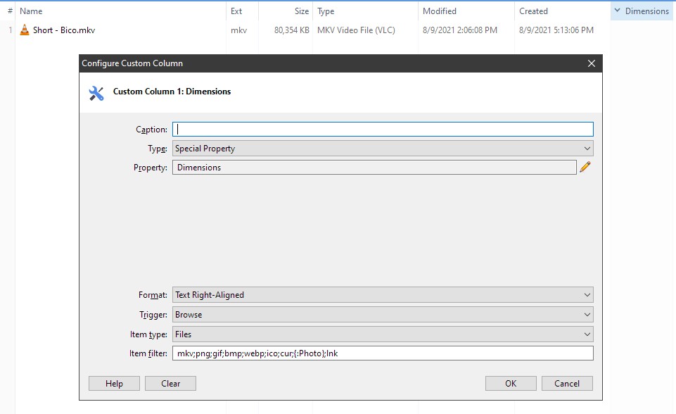

Below are my results in a ::fresh instance of XY v26.20.0205 on Windows 10 x64.
Since it works for you, and for a large fraction of my other MKVs, can you suggest why it doesn't work on this one on my PC? Something I can investigate maybe.
[SIDE NOTE. With this Bico video I get the same result with a Trigger of "Browse" or "List". If I choose "Click" for the Trigger, I see a green "play" arrow in the Dimension box (see second picture below). If I click on that arrow, it just disappears, leaving an empty box. For an MKV file for which dimensions are displayed with "Browse" or "List", if I choose "Click" I get the same green arrow. But now when I click on the arrow it disappears and the dimensions are displayed. Probably nothing about this is surprising; just thought I'd mention it].

Re: Put video resolution into "Dimensions" column too?
Posted: 17 Jul 2024 09:14
XYplorer does not retrieve this information natively for MKV files, but uses the shell, which in turn uses a property handler, which is usually installed along with the application/codec you use to preview a certain file type, in this case MKV files.
Here I'm using K-Lite Codec Pack v56.
(Use Sysinternals Process Explorer to find out what you are using.)
Posted: 17 Jul 2024 17:36
by Malarki
Thanks! I've read the caveats on K-Lite Codec and decided to go ahead and install it. That fixed this symptom, and will probably let me play a few very old video files that had just stopped working (if they aver did) under VLC, which was the only major video tool I had installed.
