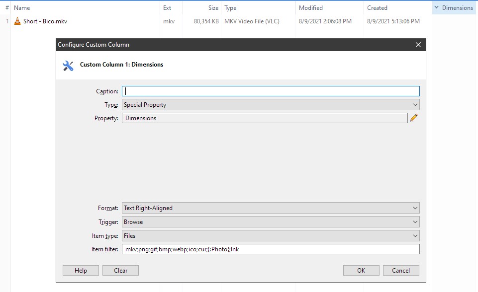

Below are my results in a ::fresh instance of XY v26.20.0205 on Windows 10 x64.
Since it works for you, and for a large fraction of my other MKVs, can you suggest why it doesn't work on this one on my PC? Something I can investigate maybe.

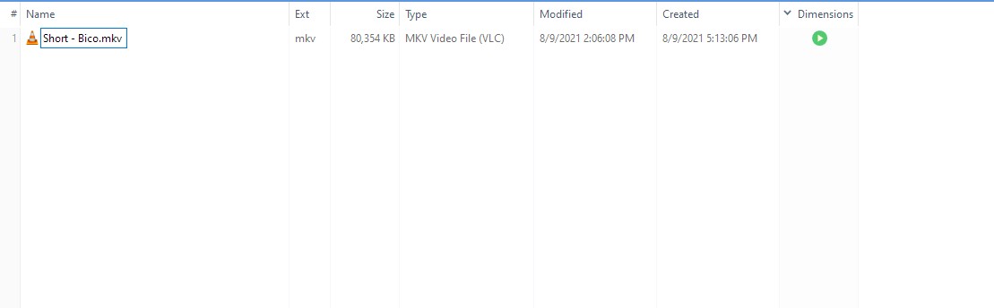

[SIDE NOTE. With this Bico video I get the same result with a Trigger of "Browse" or "List". If I choose "Click" for the Trigger, I see a green "play" arrow in the Dimension box (see second picture below). If I click on that arrow, it just disappears, leaving an empty box. For an MKV file for which dimensions are displayed with "Browse" or "List", if I choose "Click" I get the same green arrow. But now when I click on the arrow it disappears and the dimensions are displayed. Probably nothing about this is surprising; just thought I'd mention it].
