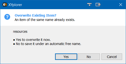

When I copy a group of files and directories from elsewhere and drop them onto a directory in Xyplorer, I get the "Overwrite Existing Item?" dialog box, but there is no way to tell Xyplorer to overwrite all from then on. I searched here in the forums, and in the configuration options, but have not found how to implement the "overwrite all" option. Surely it exists. What am I missing?
- No way to overwrite all?
- Snap52.png (13.12 KiB) Viewed 1813 times

I selected a group of files and directories from a file explorer window, hit Ctrl-C, then started a Paste operation in a Xyplorer pane where older versions of a lot of those files already existed. Every time a previously existing one was found, that dialog box appears. I am wondering if there is a way to tell Xyplorer I want all previously existing files overwritten with the ones copied into that pane.

Yesterday I did just like you, trying to reproduce kger's issue but I never got the "Overwrite Existing Item?" message showed in kger's image, no matter I tested with a recent version of XYplorer or 2 older ones. I got
all other messages you described, depending on the modification made temporarily in my XYplorer settings before the tests.
Then I googled on : XYplorer "Overwrite Existing Item"
It returned an interesting link from 2020, which shows an image of the same error message than OP's "Overwrite Existing Item?" with a discussion about it (where Don gave his opinion too)
viewtopic.php?t=21945
Maybe the link could help to solve kger's issue because if it is an XYplorer message (as it seems) then Don knows probably in which case(s) this message is displayed. I don't think it's a Windows message (because of the sentence "No to save it under an automatic free name") but I may be wrong.

It took me awhile to get back to this, and to be honest, I cannot reproduce it. I should have written down the details of what I was trying. Anyway, trying version 26.00.0002, I have not been able to reproduce the issue. If I stumble into it again, I will follow up here.

it seems to be happening when a zip file is opened in explorer and you drag and drop files on a folder in XY.
Just tried with latest XY release.

Indeed, if "Configuration | Colors and Styles | Templates | Dropped Messages | Auto-increment filenames on collision" is unchecked. I'll see what I can do.

So, does it work for you? (v26.00.0201 and later)

Works for me ! Thanks Don
