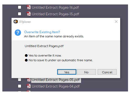

For years, I could open a pdf and manually drop individual pages from the pdf into Xyplorer and it would auto increment something like this:
Untitled Extract Pages-04.pdf
Untitled Extract Pages-03.pdf
Untitled Extract Pages-02.pdf
Untitled Extract Pages-01.pdf
Untitled Extract Pages.pdf
But several months ago something changed.
No instead of auto incrementing, it pops up a box that says " Overwrite Existing Item?"
I've attached a screen shot of the pop up.
I've tried a few things I've seen on here but I'm doing something wrong.

Do you have Tools > Configuration > Safety Belts, Network > Confirm drag and drop, and/or Confirm copy and move operations, enabled? If so, does disabling both options help?

I can confirm the behaviour you're seeing. According to the help file:
Any file operations triggered by drag and drop to XYplorer from another application are not spawned to XYcopy.
...which seemingly means no options available, unfortunately.

What happens if you click No on that dialog?

RalphM wrote: 13 Jul 2020 03:49 What happens if you click No on that dialog?
It will auto increment. But I used to be able to just drag and drop nonstop with no prompt popping up

I will add an option to Configuration | Colors and Styles | Templates | Dropped Messages: "Auto-increment filenames on collision"
