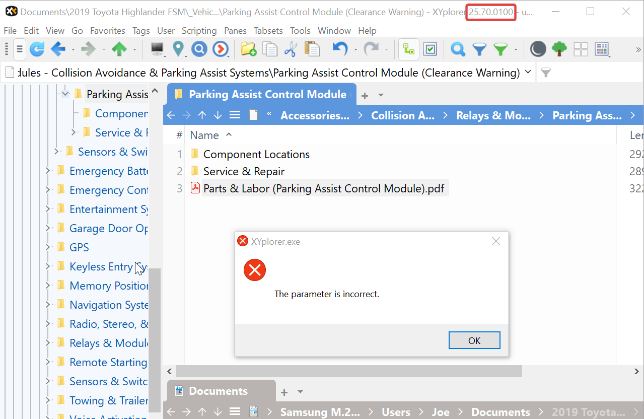

I'm running Windows 10, and I bought a lifetime license last month because I needed a Windows Explorer alternative that could work with overlong file paths, and so far this software has been amazing. For the past month, it's been working great, until today. Now for some reason it fails to open the file and just displays an error window saying "The parameter is incorrect". I've tested and verified that PDFs with paths shorter than the 259 limit open just file from XYplorer. I've tried restarter both XYplorer and my computer, but the problem persists.

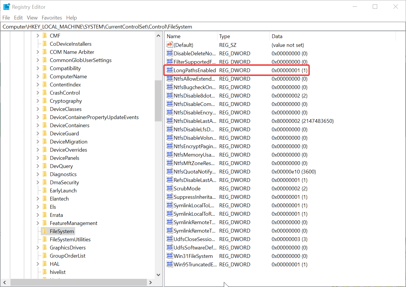

- I have the Window registry key added to enable long paths.

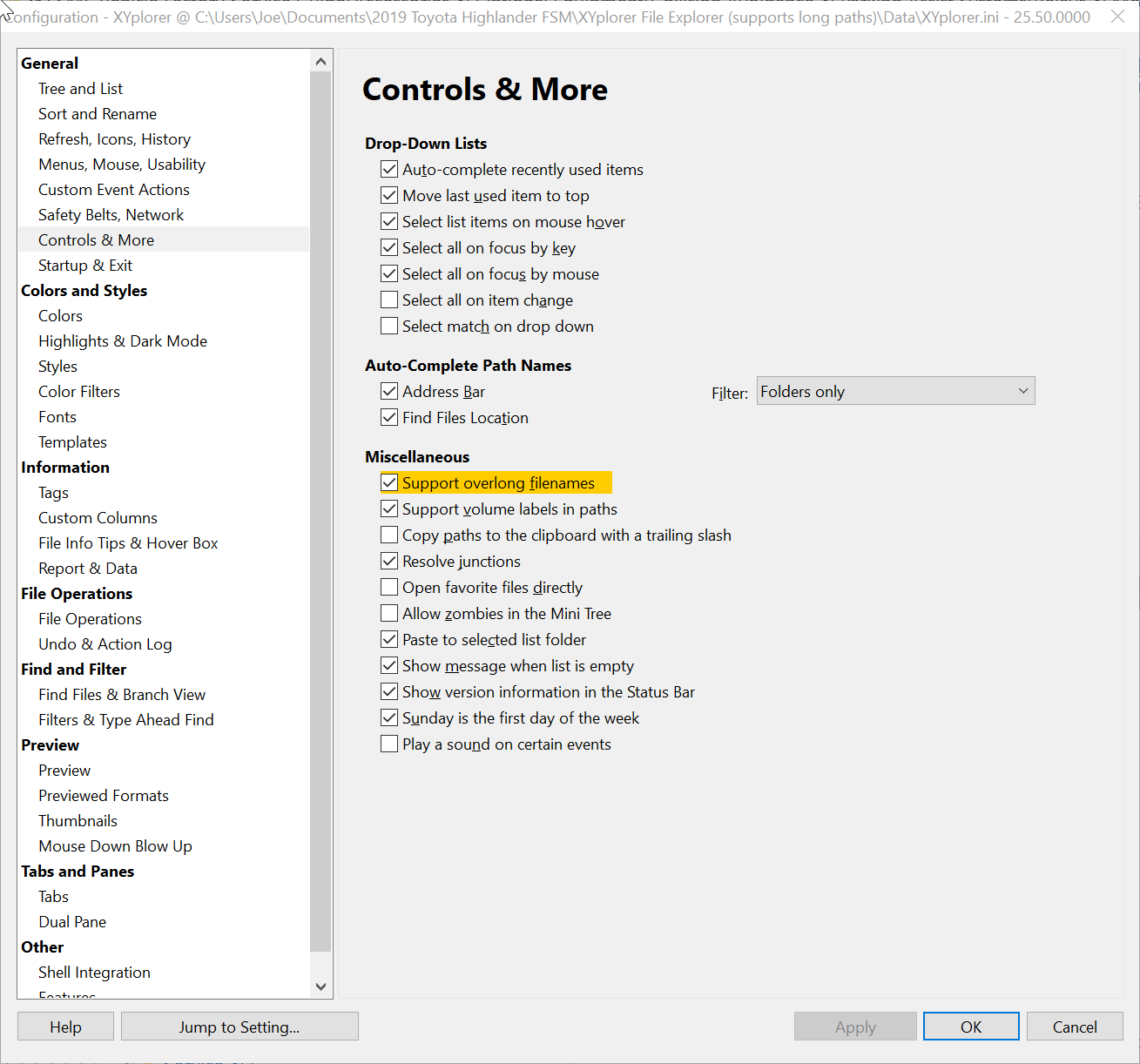

- I have overlong support enabled in XYplorer settings.
- Surprisingly, Windows Explorer was able to navigate to this file and open it with no issue.
I've search the forums for an answer, but I haven't found my exact situation duplicated anywhere.
Any ideas? Or is this a bug I've found?

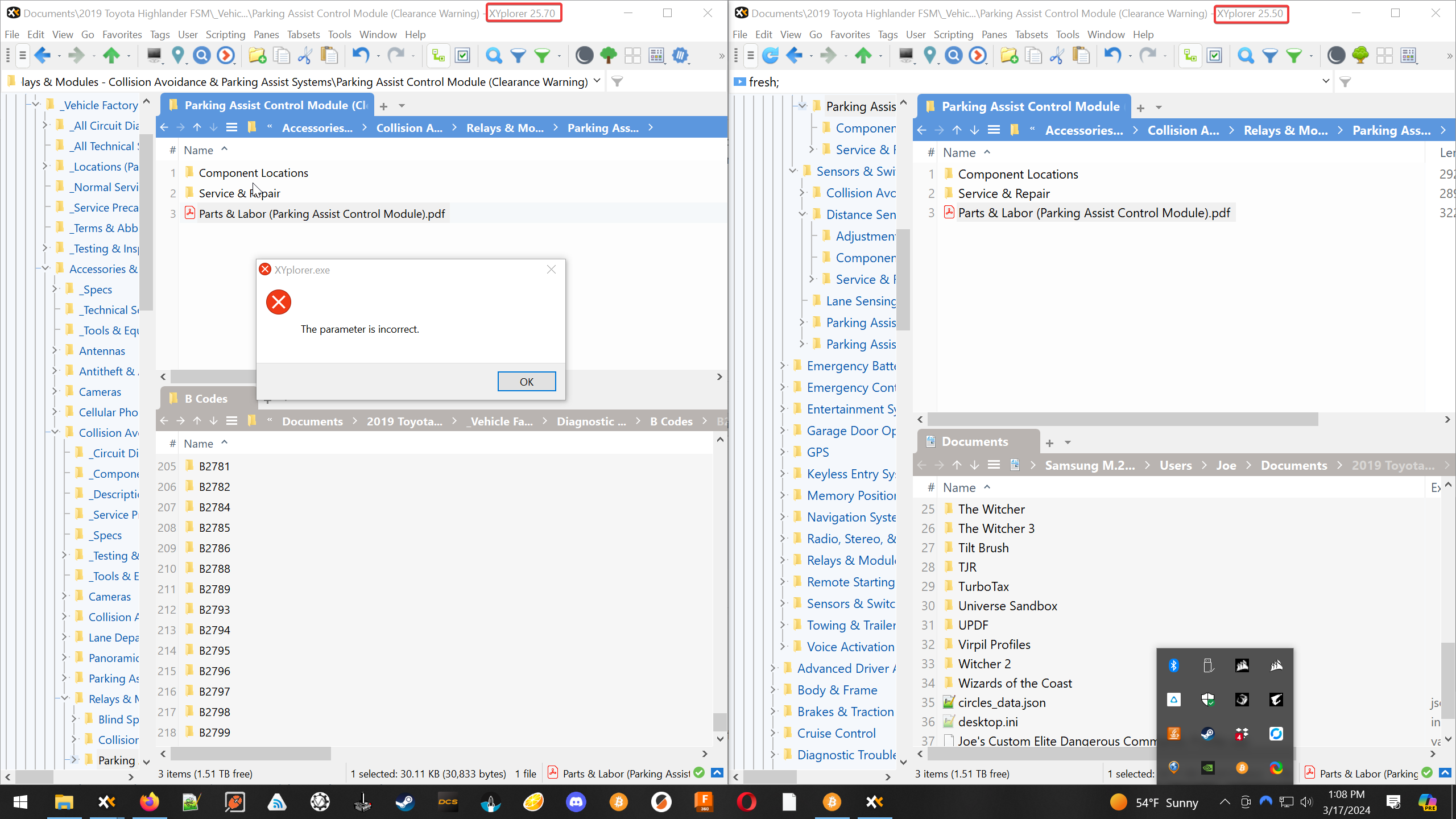

Just for fun, try a virgin instance: paste fresh; into the XYplorer address bar and hit ENTER. Can you open those PDF from this instance?

I tried making a fresh instance like you suggested, but no luck. :cry:

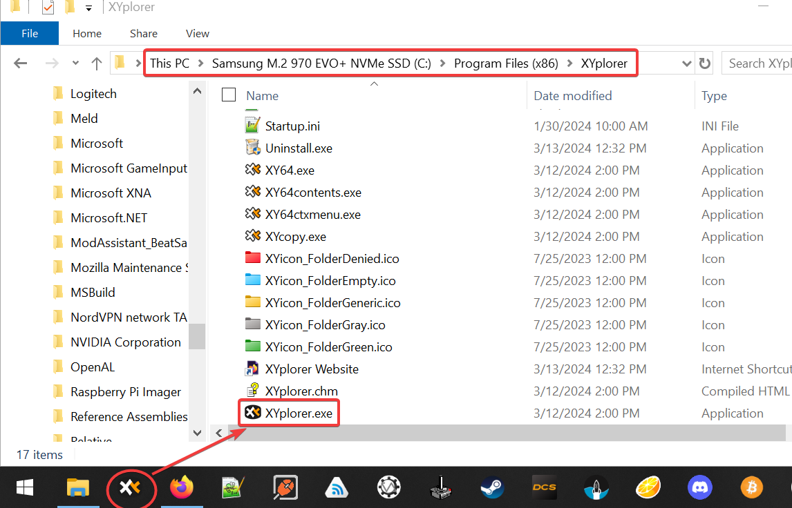

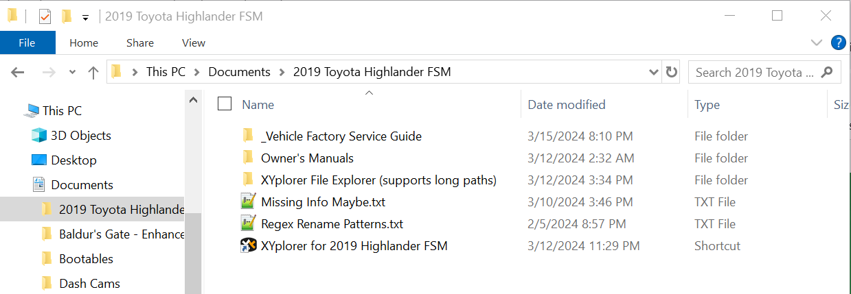

But I do remember one thing that I wonder if it's relevant. Doesn't seem like it should be, but maybe it is. Here's the story:
The main reason I wanted a Windows Explorer alternative is because I downloaded a factory service manual for my car and organized it into a folder tree structure that more or less emulates a table of contents. That's when I crashed into WE's inability to deal with file paths that get too long. So looking at alternatives, I tried out your evaluation version, really liked its handling of long file paths, it's ability to tag folders and files, and its standalone portability. So I bought a lifetime license. That portability may(?) be coming into play with my issue.
First, I did a normal install of XYplorer to my system, installed to one of the C:\Program Files location, and I have it parked alongside WE so that, over time, I can maybe transition to using it as a complete WE replacement.

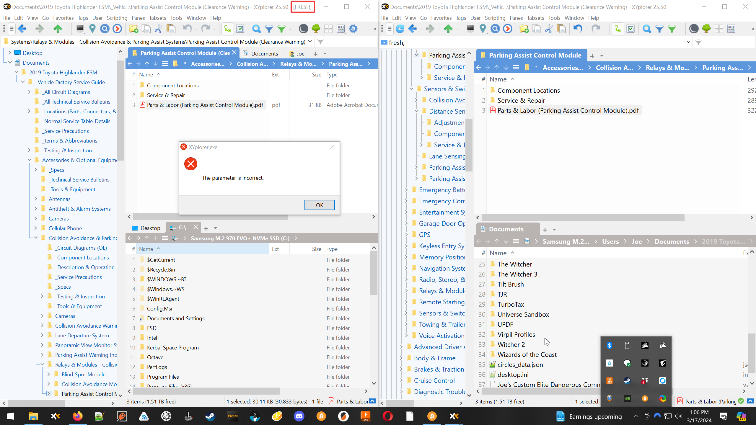

I also remember that the install for my system recently updated after I changed the setting that made it automatically check for updates, so now it's version 25.70. The portable install attached to my FSM directory has not been updated, and is still 25.50.
XYplorer Different Versions.png (501.88 KiB) Viewed 2985 times
Could it be the issue somehow?

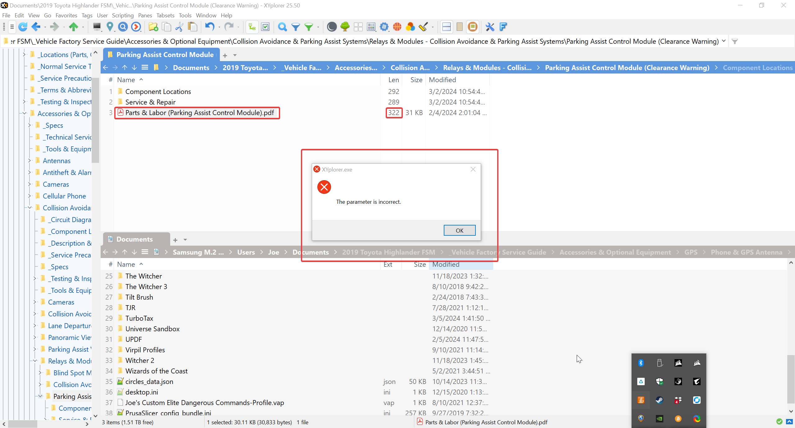

Are you saying that 25.50 still opens PDFs with overlong paths? I don't think so, because one of your first screenshots shows 25.50 with the error message.
By the way, this error message is not owned by XYplorer. It might be from Windows or from Adobe.

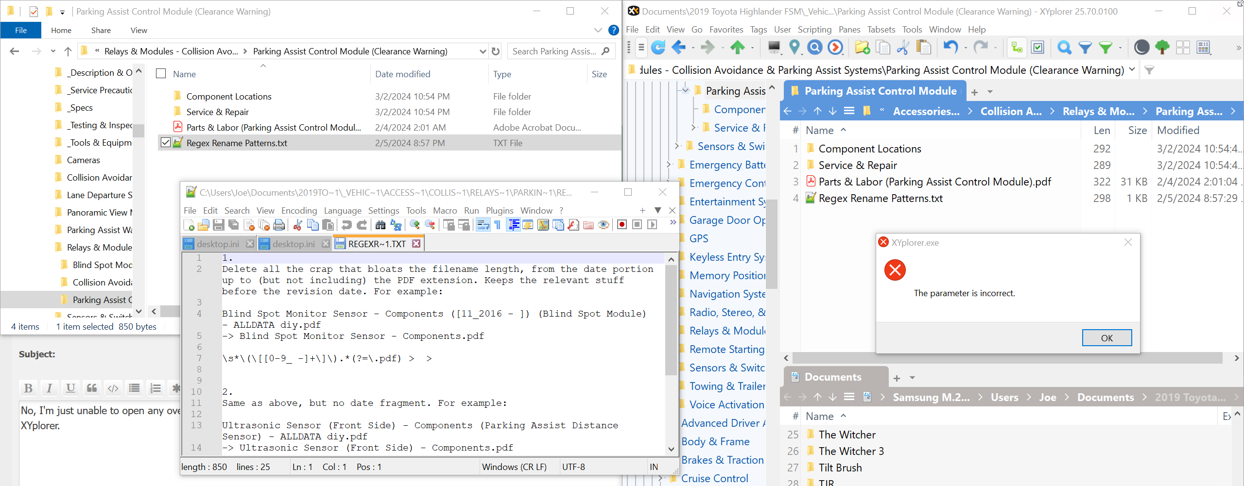

No, I'm just unable to open any overlong-path file with any of my XYplorer installs. I just tried copying a TXT file to the overlong folder location, and I got the same error message when I tried opening it from XYplorer (right half of screenshot). But the same file still opens just fine from WE (left half), but you can see the weird shortening of names in the WE view of the file.
