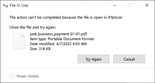

XYPlorer locking PDF files
Unable to produce an error report but if I try to delete or move a PDF file windows says it's locked by xyplorer. Closing xyplorer fixes the issue.

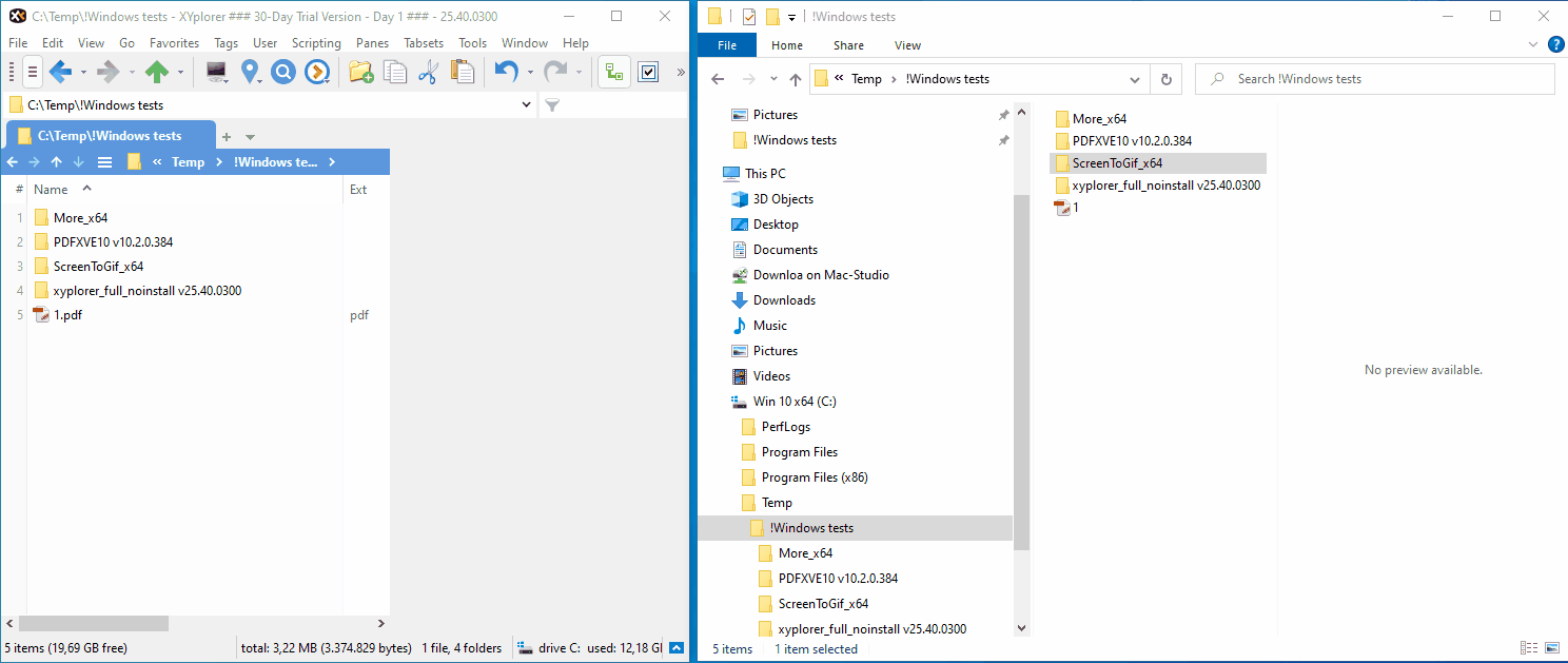

Even in a fresh instance?
Because I can't confirm that observation...
XY v25.40.0300, fresh
PDF-XChange Editor (free) v10.2.0.384
I'm creating a copy of the 1.pdf in XY, preview it in XY, change to File Explorer, select the same file and delete it...

In works in a fresh instance

So the "XY64.exe" is responsible for holding the lock...
It blocks the preview handler so that no other process has access anymore, e.g. if you're having the File Explorer preview window open and view e.g. 1.pdf, switch to the same file in XY, the preview of File Explorer "gets lost" with: This file can't be previewed because it is in use...

I went back to 22.70.0000 (11-Jan-2022) and saw the error happen again. The PDF was locked. I ran Lockhunter but it was unable to locate what was locking the file despite the error pointing to XYplorer. I closed out of XYplorer and tried a later version but was unable to replicate the error. I tried 22.70.0000 (11-Jan-2022) again and was unable to replicate the error. I tried multiple other versions up to the current 25.40.0400 (15-Jan-2024) and was unable to replicate the error. I made multiple copies of the PDF file and they were deleted without an issue. I suppose I'll have to try again after a reboot or some other day, it's not the top priority for me. It's just an annoyance.
While writing this I thought I'd delete the file again using 25.40.0400 (15-Jan-2024), PDF locked.
I suppose I may need to wait several minutes after installing the older versions. Is this something really with XYplorer or a Windows (update) issue? I don't believe I had any problems with PDF files being locked in the past. Until around four to six months ago.

You are deleting with XYplorer or with another app?
