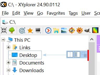

I was having trouble too until I figured out exactly where the hover needs to happen. Please your cursor just to the left of the 'dividing' panel between the tree and the list (marked in red on my screenshot).
EDITED TO ADD: The cursor can be placed further in than that but if it works right next to the dividing panel, at least you'll know it's working. [Thanks Don for pointing out that my comment was misleading.]

- Posts: 67224
Re: Can't get Glider to work
The pic is misleading. The hover zone is at least as wide as the scrollbar (can be made 4 times wider).
kiwichick
- Posts: 732
- Joined: 08 Aug 2012 04:14
- Location: Pahiatua, New Zealand
Yes, you are right. Maybe I should have worded my comment better. I was trying to point out that by starting at least that close to the dividing panel, it would be obvious if the glider is working or not. I'll re-word my comment.
