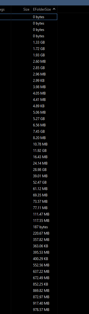

Not sure if this is an issue. If Sort Folders Apart is checked, the custom column of the folders cannot be sorted.
If uncheck Sort Folders Apart, it will be sorted by number, I can modify the script to sort, it would be better if it can be improved.

Maybe I did not understand what you mean, but I can sort folders by a custom column:

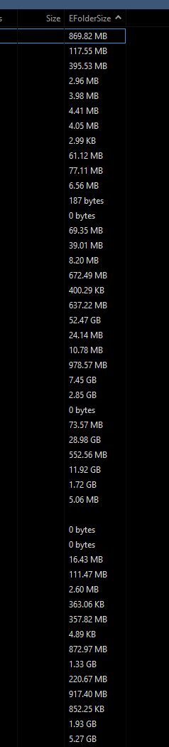

1) I checked this option:
Configuration | General | Sort and Rename | Sort | Sort folders always ascending
2) If it can be improved, a custom column with random folder size:
Snip: CustomColumn 1
  XYplorer 24.40.0208, 2023/6/6 18:24:47
Action
  ConfigureColumn
Caption
  FolderSize
Type
  3
Definition
  $state = rand(1, 5);
   switch ($state) {
    case 1:                 return formatbytes(0, "FLEX");
    case 2:                 return formatbytes(rand(0, 99999), "FLEX");
    case 3:                 return formatbytes(rand(99999, 999999), "FLEX");
    case 4:                 return formatbytes(rand(999999, 99999999), "FLEX");
    case 5:                 return formatbytes("99999999999", "FLEX");
Not a problem, not sorted by KB, MB, GB.

Ah I see. Try Format "Bytes".
And change your script to:
 switch ($state) {
  case 1:                 return 0;
  case 2:                 return rand(0, 99999);
  case 3:                 return rand(99999, 999999);
  case 4:                 return rand(999999, 99999999);
  case 5:                 return "99999999999";
