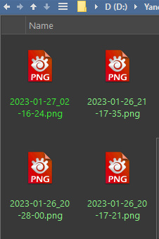

It doesn't create thumbnails after updating to 24.00 (tried latest 0100 update as well). I tried clearing cache, changed cache path to a new folder and now I see how it creates thumbnails for folders but not for images (which is weird cause the folder with images will have a thumbnail while all the images inside will have no thumbs).
I use XNView to view images, and now all the images have it's icon.

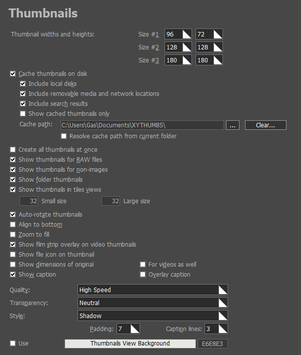

What can I do to bring back thumbs? I view all folders as "Thumbnails #1" and having no icons is a disaster. My settings for thumbs:

Not really. The settings look okay.
