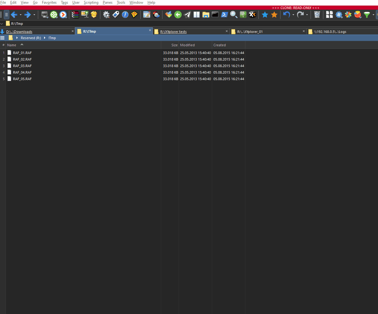

Re: Searching for files hidden with Ghost Filter
Post by o7blue »
So I didn't get the expected results (nothing found). I also tried the 'Find Files' dialogue with the 'Find hidden' option selected, and it couldn't find the file when hidden with ghost filter. Is this working as intended?
Posts: 14578
Post by o7blue »
Still seem to be getting different results, XY 23.10
https://youtu.be/XnRanT7gzcE
Posts: 14578
I don't have time to try that on a 6 month old version. Try the current one
Post by o7blue »
Geez, updating fixed it. That's what I get for thinking "surely that can't be it". Thank you for your patience highend.
