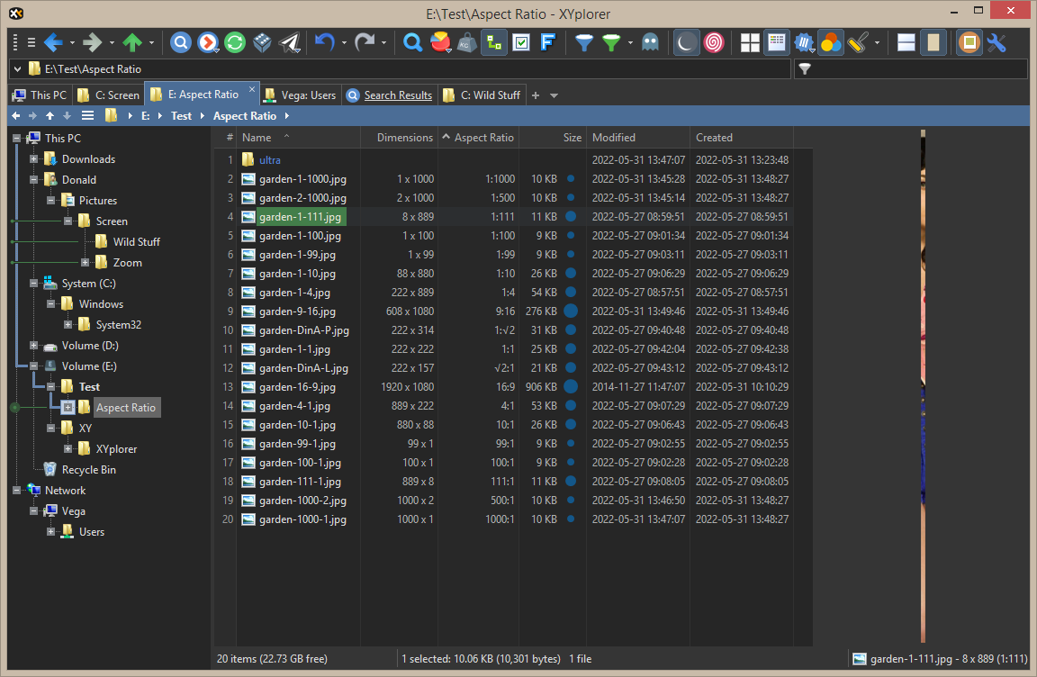

Posts: 65533
Re: Sort and filter the "aspect ratio" special property by the quotient
By the way, now we have the full range.
