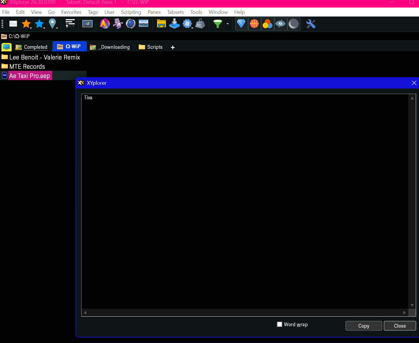

Im sorry but I have been reading the help file replacelist over and over trying to figure out how I use replacelist to remove multiple things and maybe im just totally stupid or missing something somewhere, I have even tried using some of the examples you have like i add the word Taxi somewhere in the file name and run command :
yet all that the command does is pop up a window that has the text "Tixa" in it. doesn't do anything other than that, what am i doing wrong here?
text replacelist("Taxi", "ai", "ia"); //Tixa To see the attached files, you need to log into the forum.
- Posts: 2109
- Joined: 27 Jan 2005 23:38
- Location: Cairns, Australia
Re: How to script Search and Replace functionality?
What did you expect?
Text = open a window showing the result of your replacements
replacelist = with these two lists "ai" "ia" you are replacing all "a" with an "i" and all "i" with an "a"
So the result "Tixa" is correct.
