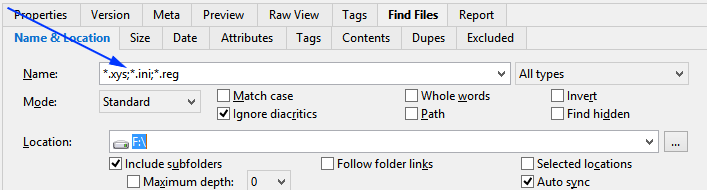

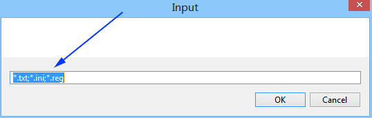

Question 2:
(Please look at the pictures below.)
Why are these two input boxes/combo-box not Edit Text?
Semicolons and asterisks don't look very clear.
Thank you.

2) Mixing fonts here could break the layout. (It might work in the dialog but then there is inconsistency between dropdowns in dialog and in main form.)
