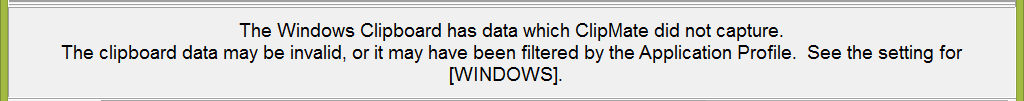

XYplorer is doing something non-standard with copy:
Ctrl+C from XYplorer, the clipboard looks like:
Ctrl+C from File Explorer, the clipboard looks like:
The Application Profile is WINDOWS for both situations.

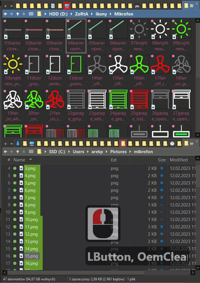

shrtcuts ctrl+c and ctrl+v during copy files betwen folders dosen't work. After press ctrl+v XYPplorer back to source folder.
Checkbox: Configuration | Other | Shell Integration | Drag and Drop | Extended compatibility for clipboard and drag and drop checked/ticked.
Where i doing wrong? What can i fix it?

RalphM - thank You - but i can't copy any file on one times - i don't try new copies during another copy process. If i need copy file/or i must use windows explorer.
Look on attached screens.
I saw - sometimes work - on previous screens works, but now i cant copy...
Regards
