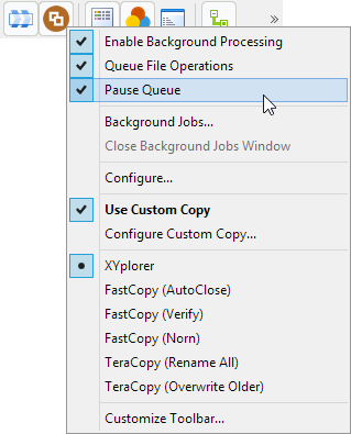

Posted: 11 Jan 2024 08:52
Tick Window | Show Status Bar Buttons.
Then enable Background Processing and Queue File Operations and Pause the queue. Here this is done using the right-click menu of the Custom Copy toolbar button (not that below Pause Queue there is Background Jobs..., selecting this will show the same list as shown here below).
You now should see a button in the Status Bar:
Click that button to see (the still empty) list:
