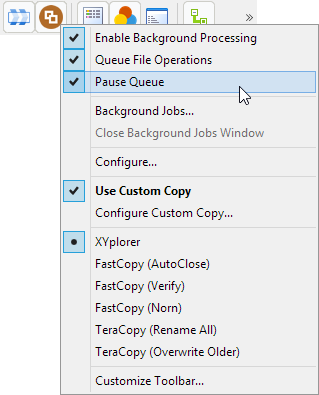

So now I got FastCopy working, but it seems that FastCopy doesn't even ask what I want to do on name collisions, merging folders, etc.
The main reason why I was trying to use FastCopy instead of XYplorer CustomCopy was because of the Queue operations. If I start a copy while another one is in progress, there is no indicator that the second copy is in the queue. This becomes problematic when I'm queuing 5 operations.
However, I was just reading this thread, and it seems that this shouldn't be happening, and it's not the normal behavior for XYcopy: viewtopic.php?p=206235&hilit=queue+copy#p206235.
In the thread, they are mentioning a LIST and a way to start a second job from that list.
In this thread there is also a mention of a background job list: viewtopic.php?p=206234&hilit=queue+copy#p206234
I don't have any list showing while queuing copies. Is there any setting for that?

- Posts: 66365
Re: Use external CopyHandler (ExtremeCopy) as default for copy/move operations?
Tick Window | Show Status Bar Buttons.
Then enable Background Processing and Queue File Operations and Pause the queue. Here this is done using the right-click menu of the Custom Copy toolbar button (not that below Pause Queue there is Background Jobs..., selecting this will show the same list as shown here below). You now should see a button in the Status Bar: Click that button to see (the still empty) list:
