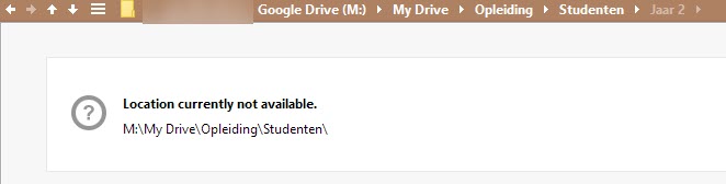

I am having trouble with XYplorer regarding network drives. Here is what XYplorer shows:
This drive is a mapped drive created by Google Drive app (Google Drive for desktop). However, the same applies to mapped shares to my NAS.

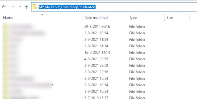

In Windows Explorer, I get this:
As you can see, the network share is accessible. Also, the mapped shares to my NAS are available in Windows Explorer but not in XYplorer. That is quite an issue for me because I use many files in these mapped drives/shares daily. This issue happens intermittently. Sometimes the mapped drives/network shares are available, but a few minutes later, they can be gone, and the above error message is there. It is related to XYplorer because all files are perfectly accessible using Windows Explorer when I have this problem.
