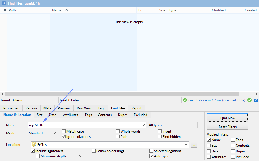

Question 1:
ageM: 1 h
This expression can search for files.
ageM: 1h
This expression cannot search for files.
Why? Thank you.

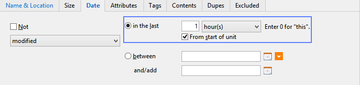

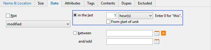

Question 2:
ageM: <= 1 h
The options on this picture are equivalent to this expression.
What expression is equivalent to the options on this picture?
Thank you.

Question 1: This is how the syntax is defined: there MUST be a space between counter and unit.

But I tested that the result of the following expression is the same.
:*.cpp AND ageM: <= 1h
:*.cpp AND ageM: <=1 h
:*.cpp AND ageM:<= 1 h
:*.cpp AND ageM:<=1h
Posts: 67271
Re: About search (added picture description)
kuiwu_zh wrote: ↑28 Jul 2021 10:54 But I tested that the result of the following expression is the same.
Maybe the same but WRONG. When the space is missing the unit will fall back to *days*, not hours.
Posts: 67271
But relax. I just added a bit of tolerance. From the next beta onwards that space is optional.

How do I write the expression of Question 2?
Posts: 67271
kuiwu_zh wrote: ↑28 Jul 2021 11:21 How do I write the expression of Question 2?
Good question. These terms are always treated as "start of unit", so it's only possible by changing the unit. Instead of "1 d" you can use "24 h" or "1440 n" depending on how exact you want it to be.
