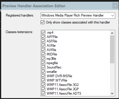

You may try to assign the video formats which are not correctly previewed to the
Windows Media Player Rich Preview Handler
Use the Preview Handler Association Editor.
https://docs.microsoft.com/de-de/archiv ... ion-editor
Remove the "Only show ..." option and assign the additional extensions.
Its working without any restarts.
XYplorer preview will then hopefully show a Media player screen and you can push the start button.

Tanker IP wrote: 05 Jun 2021 16:33 UPDATE #2 Well, well........ My WMP is not working it seems. At least here on my desktop. It freezes everytime I try to play something.
Question: Is Xyplorer preview for videos supposed to be tied/linked to Windows Media Player in some fashion? If I get my Windows Media Player working, then I have a better chance of having XYplorer running correctly in preview?
Thanks to highend and horst for their contributions.
For me there is a link to the Windows Media player if I assign the extensions as explained above.
Without this XY previews the video without any Media player screen and without the need to hit a start button.
The Windows media player works fine for all sort of videos after the setup of the K-Lite package which includes to support the player.
