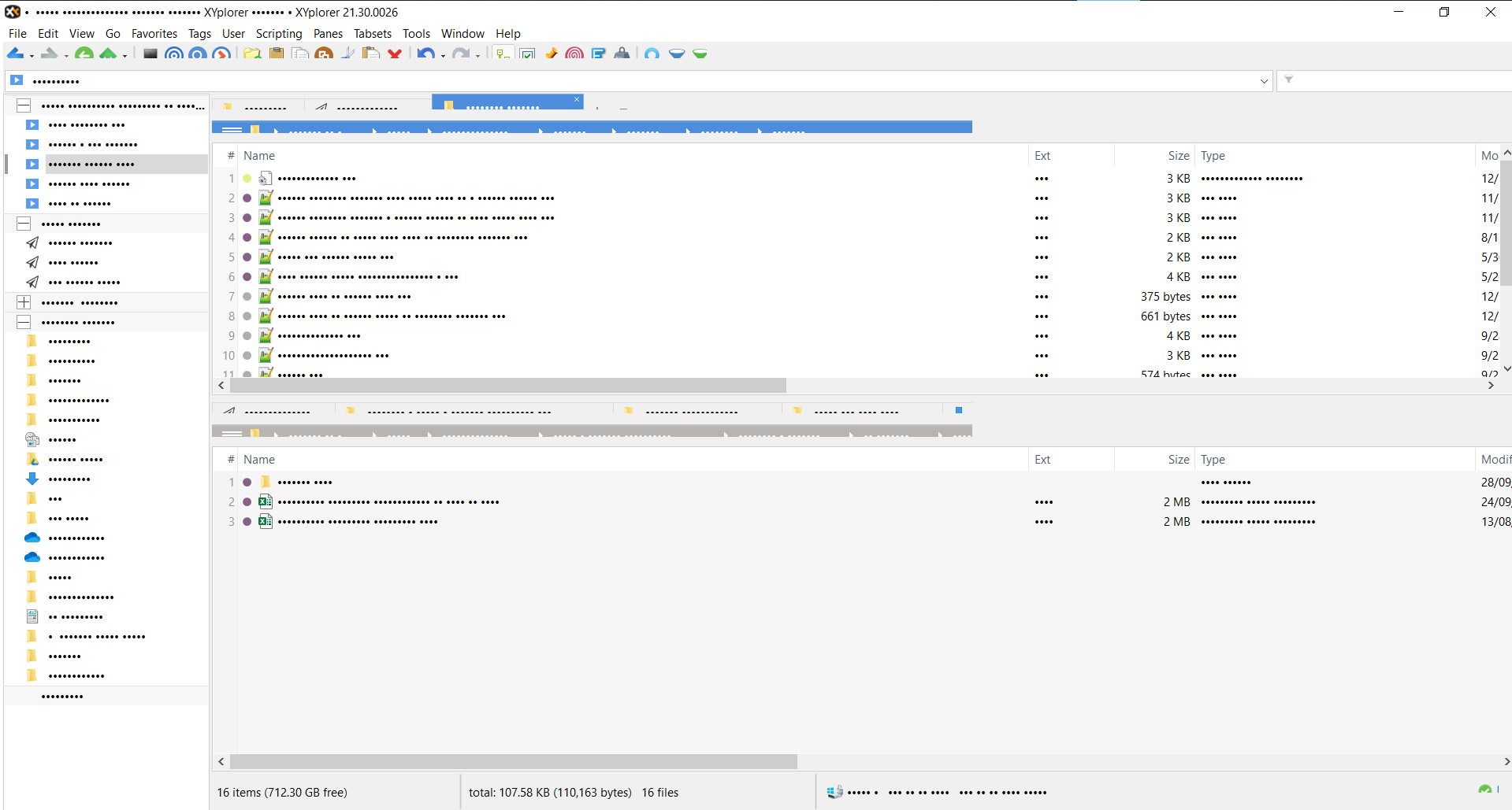

Unfortunately, no joy. We've gone backwards. The toolbar, tab and breadcrumb lines are now only displaying half height on both the Primary and Secondary screens (see images below). Scaling still doesn't work on the Secondary screens.
Here's the primary screen:
Primary Screen
Primary Screen
201209_Primary Screenshot.png (91.14 KiB) Viewed 4693 times
And the screen; output for the Primary Screen:
201210_Primary Screenshot.png (95.06 KiB) Viewed 4665 times
