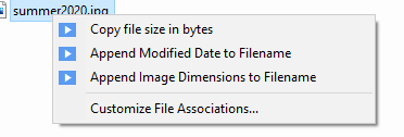

1) I assume when you select such a file and then open the Open With menu in XYplorer (File | Open with... (Ctrl+Alt+Enter)), you see something like this (in your language):

Attached is what I get, assuming portable file associations is enabled. In windows explorer it just works, going to the default program I selected.
- Screenshot 2020-09-28 140137.png (5.3 KiB) Viewed 4705 times

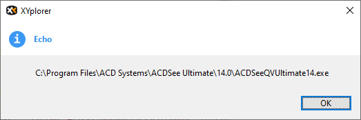

Please run this through the XY address bar:
What is returned?
echo get("assoc","jpg");FAQ | XY News RSS | XY X
Re: Having problem when opening photo in XYplorer.
An empty popup msg.

admin wrote: ↑28 Sep 2020 19:35 Please run this through the XY address bar:What is returned?Code: Select all
- Picture2.png (6.17 KiB) Viewed 4701 times

That ACDSee path looks good, right?
