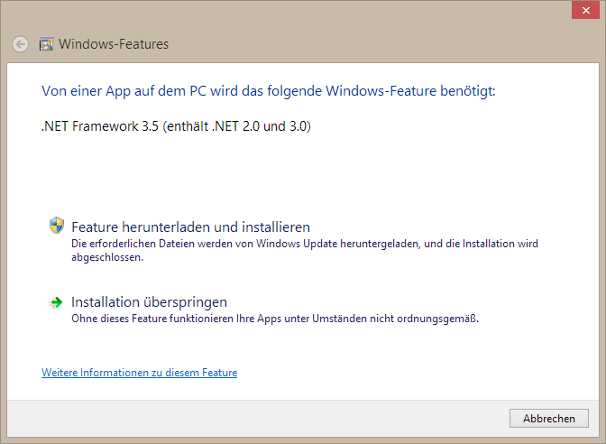

Sounds interesting but when I run PreviewHandlerEditor.exe I see this:
Strange, because I have .NET 4.8.03761 on my system. :? Any idea?

You need to enable the .NET Framework 3.5 feature via Control panel - Turn Windows features on or off... - Wizard
Re: How to enable preview using Sumatra, while using Acrobat as default PDF editor
Posted: 24 Apr 2021 12:35
Thanks. I assumed .NET was downward compatible. :roll:

Not with 3.5^^

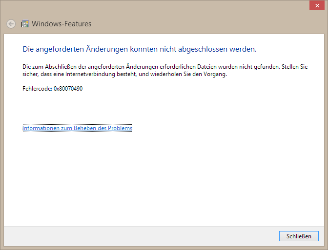

It forced my to download stuff for minutes, and then this:
Link goes to this page where my error code does not exist: https://docs.microsoft.com/en-US/troubl ... tion-error
Thank you, Windows. Just great.

First I would try it after a reboot.
If this doesn't help try an Offline Installation of .NET 3.5
https://sourceforge.net/projects/framework-3-offline/
