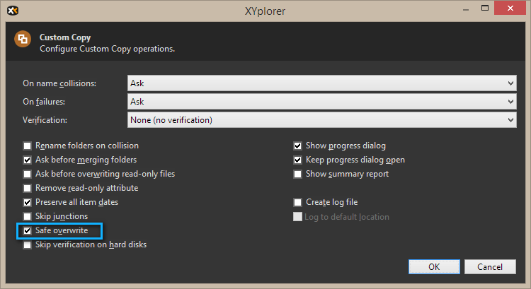

That "~SafeOverwrite.tmp" file is only created when you tick the "Save Overwrite" option in the Custom Copy configuration:
But I'm not aware of recent changes that could cause any issues here. The issue is that files are not overwritten that should have been overwritten?

Yes, files that should be overwritten don't get overwritten and there are lingering ~SafeOverwrite.tmp files. If I find a consistent way to reproduce this I will inform you.
