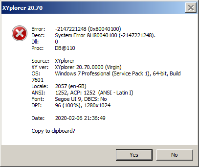

I am trying the latest version. Upon waking after a long sleep I got the attached message box.
An optical drive that had a disk in had had the disk removed. It seems that XY can normally deal with that alright though.
The duplication of file names in the listing did not occur this time, although that might be intermittent.

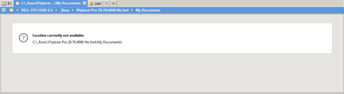

Here's some more...
Drive E: had no disk.
I inserted a CD in the optical drive E:.
Somewhere around this point I got this message:
It was not immediately recognised by XY so I tried tabbing over to My Documents intending to tab back to E:
I then got the message shown below. But there is no such path in existence!
I tabbed back to E:

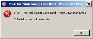

When I double clicked to play one of the music tracks in the listing I got this message.
I got around this by choosing Show 64 bit context menu and then an option from there.
I tabbed back to E:
