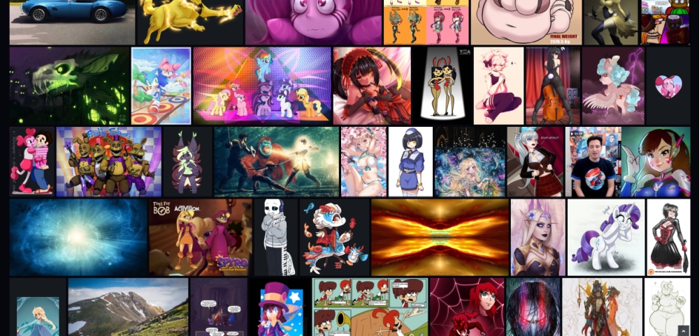

I've looked everywhere for a desktop app that allows image browsing with a masonry grid layout. Very popular on the web, but totally absent from offline apps.
It makes image browsing a lot faster (for me anyway) and you're not restricted by thumbnail size settings.
The best example is https://www.deviantart.com/
Pinterest and google images are similar, but I prefer the "airtight" variety, or close to it.
https://www.artstation.com/ is also similar.
I discovered Xyplorer during my search for an image viewer with masonry grid-view. I came up empty-handed, but Xyplorer was a lot better than what I was using before (Irfanview Thumbnail gallery).
At this point, I'm willing to put down hundreds of dollars to secure this feature, or at least support its development.
Hopefully there's others who want alternate image layouts as well.

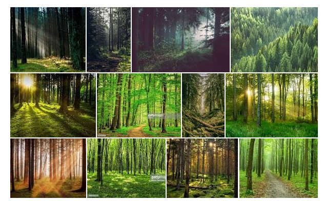

If you want a perfectly aligned block (and I think pinterest does this; the attached image has it too and is from google image search) there has to be some cutting somewhere, and this depends on the sequence of pics. I cannot (reasonably) have a cache file or each sort order, so: no caching.
If you are happy with a left-aligned wall (which would be a sub-standard masonry work IMO) then caching would be possible.
- 2019-10-06_152520.png (583.78 KiB) Viewed 6039 times
