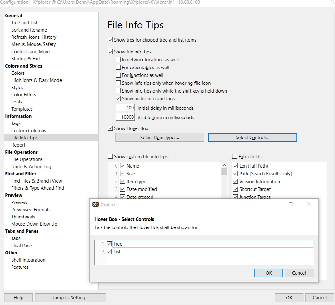

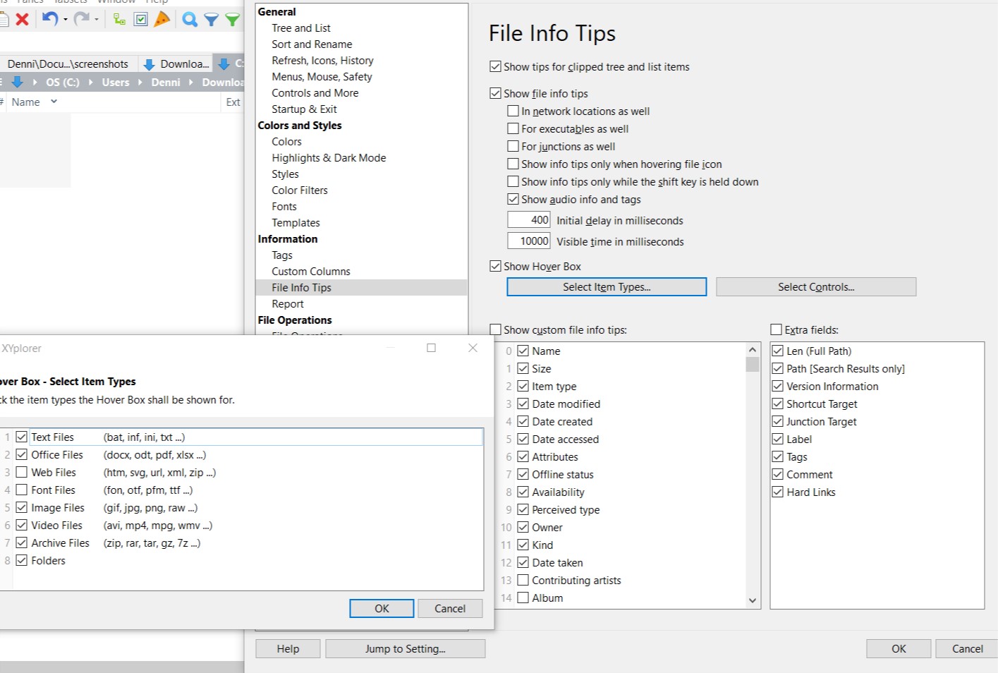

Ok. Can you show a screenshot of the "File Info Tip" Page in config?
Re: Hover Box or Picture Preview
please see attached - also, maybe I am confusing things - as far as I understand the hover box shows information on all kinds of folders or files. While this is interesting, I have not used it in the past, so don't know how much I miss it. However the preview of jpgs is very helpful and was present in XY prior to hover box (?). I would be happy if I could just this active again. The instructions used to be show image info - I guess that has been changed in one of the updates over the last year?
- FileInfoTips2.jpg (165.75 KiB) Viewed 4742 times
- FileInfoTips.jpg (190.31 KiB) Viewed 4742 times

Can I just ask a couple questions, are you getting Hover Box mixed up with MDBU ? and you say you are using a tablet, do you have a mouse attached to it?
