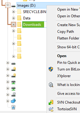

Good afternoon all,
Using the latest beta on Windows 10 x64 1809 (all patched up). If I right-click on a drive or folder in the Tree (full, not mini) I am getting a weird white-out box.
Before Right-Click After Right-Click The white-out box varies in size, depending if I right-click on something at the top or bottom of the page. Here's an example of a right-click on a folder near the top of the tree :

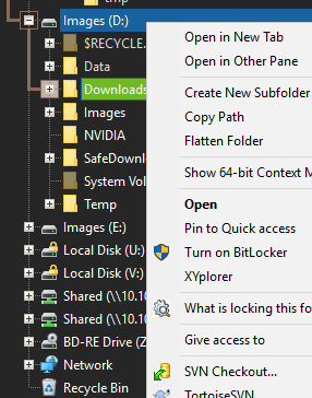

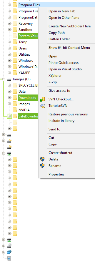

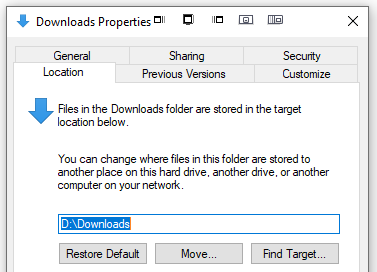

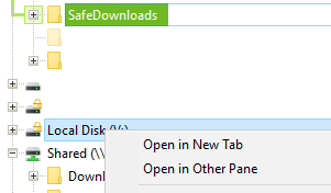

Good afternoon,
Back on this again, but with more details and consistency to reproduce.
I run dual panes. I am noticing this issue when the bottom pane is active. If I right-click on an entry in the full/max tree above the selected node, the entries below the select node (see brown box) have the white background (see Figure 1). If I right-click an entry below the selected node (again, brown box), the items up to the node have the white background (see Figure 2).
I have narrowed it down to the following conditions :
1 - bottom pane is active, I am not experiencing the issue in the top pane, no matter what type of folder is selected
2 - selected tab in the bottom pane is a locked "Windows" folder (see Figure 3), e.g. Downloads, Documents, Pictures, etc. / this doesn't seem to occur w/"normal" folders.
Please note that does not happen when the top pane is selected/active. Now that it was happening again today, I was paying closer attention to what I was selecting and where I was selecting it from.
Hope this additional information helps out.
Figure 1 Figure 2 Figure 3

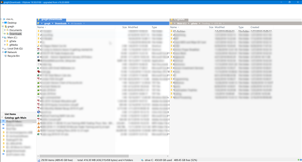

Win 10 Pro x64 on an HP Spectre x360 with a 4K monitor.

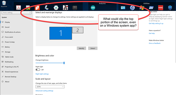

I upgraded to XYplorer ver 19.50.0100 two days ago and I've experienced a similar "White Box" issue four times. However, my white box covers the menu bar, toolbar and file location line.
I closed XYplorer and loaded the Windows Display app. The top section is blank revealing the Desktop beneath.
I always assume operator error but saw this thread and it is very similar to my experience. When I restart Windows the issue is resolved. Again, I suspect a Windows glitch but this never occurred before I upgraded to 19.50.0100 and it always seems to present there first. I did not notice this in other apps such as AmiBroker, Notepad++ or IRFan.
P.S. I can't get the pics inline so they're dropping to the bottom. I apologize for the poor display.
