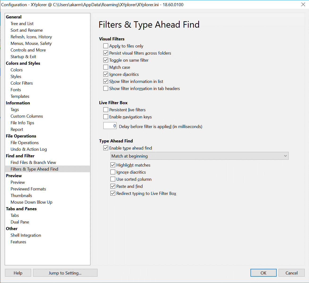

I have "Highlight matches" and "Redirect typing to Live Filter Box" enabled, but the search term is not highlighted in results (see screenshot). Thanks!

That's because you have "Redirect typing to Live Filter Box" enabled
What would be the sense to highlight matches when only matches appear in the list anyway...

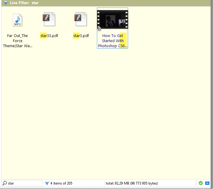

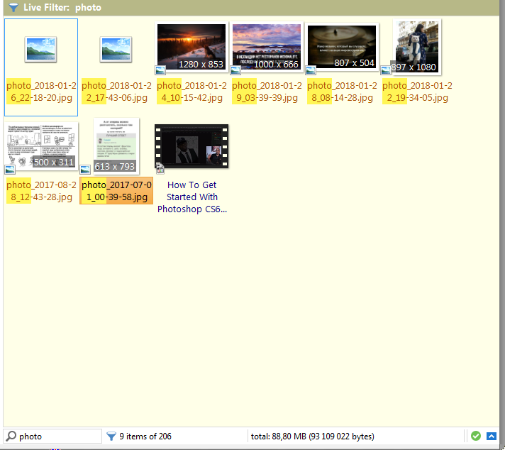

i like new Live Filter Highlight but it's has some glitches.
1. while in Thumbs view some items matching live filter aren't highlighted. 2. if typing quite fast Live Filter seem to "take it slow" sometimes = box contains filter word but in List match is made only by 1-2 first letters of filtering word. can't determine some exact reasons, maybe Thumbs view and big amount of items in list involved. "Delay before filter" is 0.

1. Indeed, this works so bad, I will just stop highlighting in multi-line captions.
2. Yes, there might be a race condition. Cannot do much at the moment.
