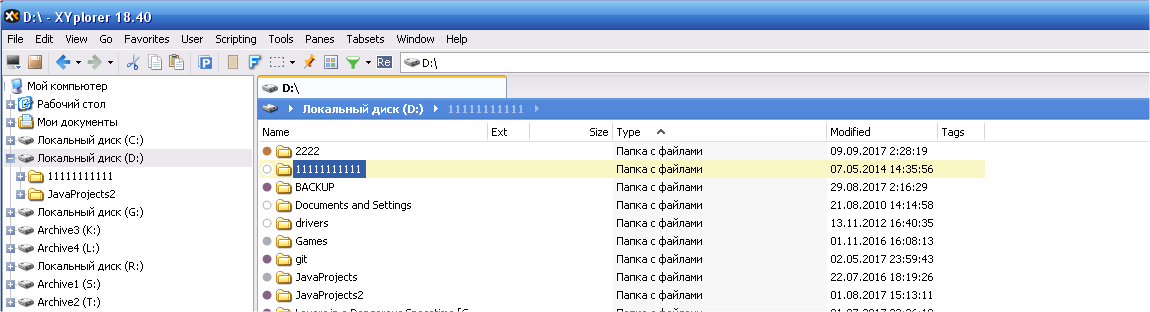

When Age graphics (circle) is enabled, file list scrolling (with scrollbar) is little slow and jerky.
When Size graphics (circle) is enabled (without Age graphics), everything is ok.
In testing file list:
Folders count: 35
Files count: 32
System information:
XYplorer: 18.40.0000
OS: Windows XP Professional (Service Pack 3), 32-bit (5.1)
Themes: Yes
Screen: 2560x1080, 1/1 (Primary), Virtual: (0, 0) - (2560, 1080), Work: (0, 0) - (2560, 1020)
Screen DPI: 96 (100%), twx: 15, stretch: 1
Screen Color Depth: 32
UseDPIAwareIconSizes: No, Yes
Icon Size: Small=16, Large=32
Icon Size Controls: Small=16, Large=32
Icon Size Recommended: Small=16, Large=32
